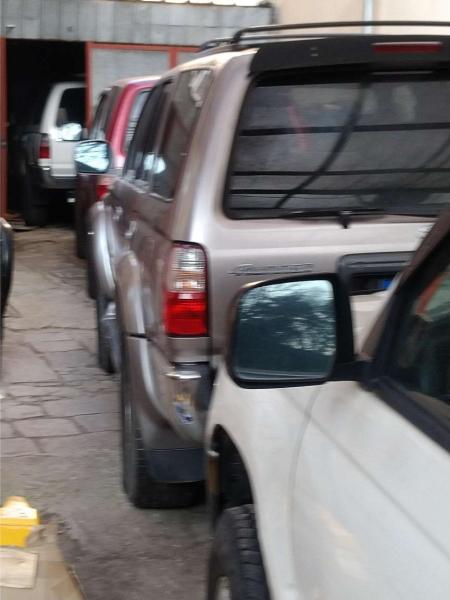

Being my fleet of 4 runners...
I kinda know what you mean!
Lol looks like 5. I have 5 currently and a 6th one for parts. It seems like a few of us get carried away. :/

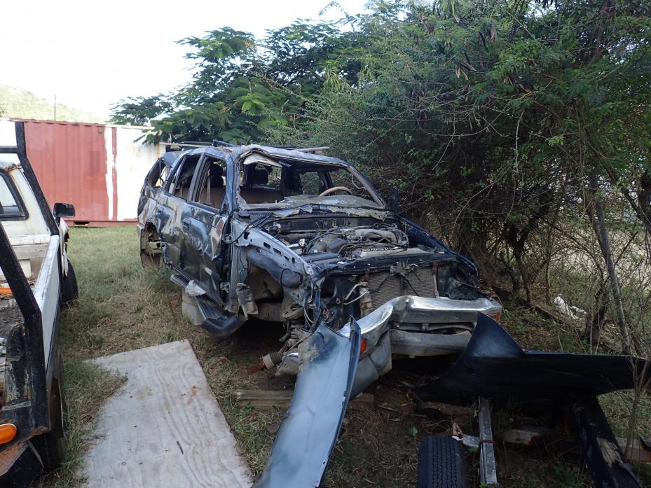

Thats the 4runner I pulled the 5 speed from for my swap. Went off the road and about 50 feet down a really steep incline. Nobody was hurt and from what I heard it got more damaged being pulled back up to the road than when it went down. It was good for lots of parts!
