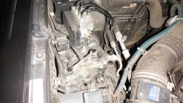

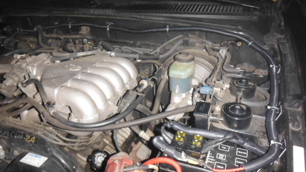

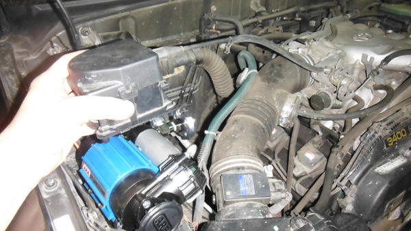

My turn to help someone out. I have a friend who is very handy at fabricating stuff, after toying with a few idea's I was still very keen on mounting the compressor in the engine bay. I have a 99 SR5 mind you, so depending on what year your rig is things may be slightly different. We examined three possible ideas, inside the truck, driver side below the battery and finally passenger side. I chose the passenger side because that was where I wanted it to go in the first place. If you look in between the ABS actuator and the Cruise control actuator there is a SMALL place to put the compressor into. I have the ARB CKMA12, which was JUST compact enough to make due in the small place I had to work with. He built a bracket that bolted onto one of the available holes in the fender and we bolted and plumbed the compressor, and the rest was history. The type of compressor will be your deciding factor, and again if it's bigger than a CKMA12 you'll probably want to look elsewhere. Remember, the compressor can be configured to mount in many configurations by playing with the mounts. You may find other ideas doing that!

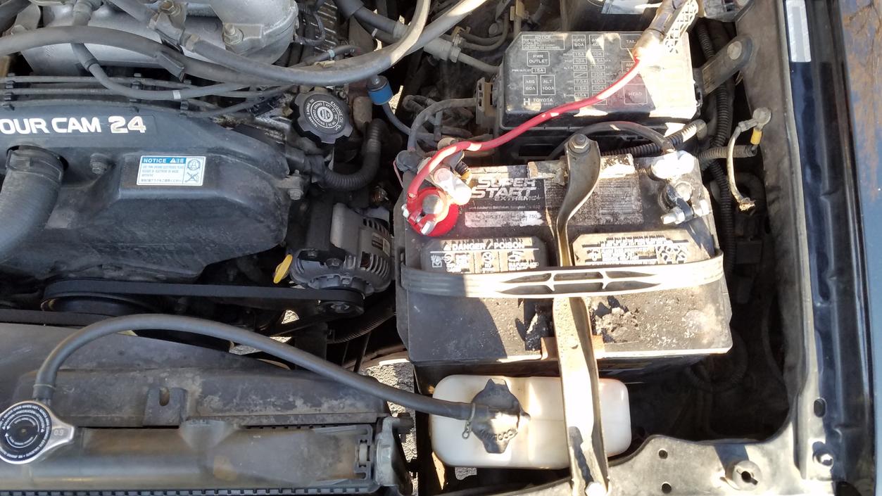

I just put a long metal plate under the battery that extends out into the engine bay enough to put the compressor on top of it. Bolted the plate down under the battery and put an L bracket under the plate for support. Pretty simple install. Yea, it's in a spot of rough environment but the things are made for it.

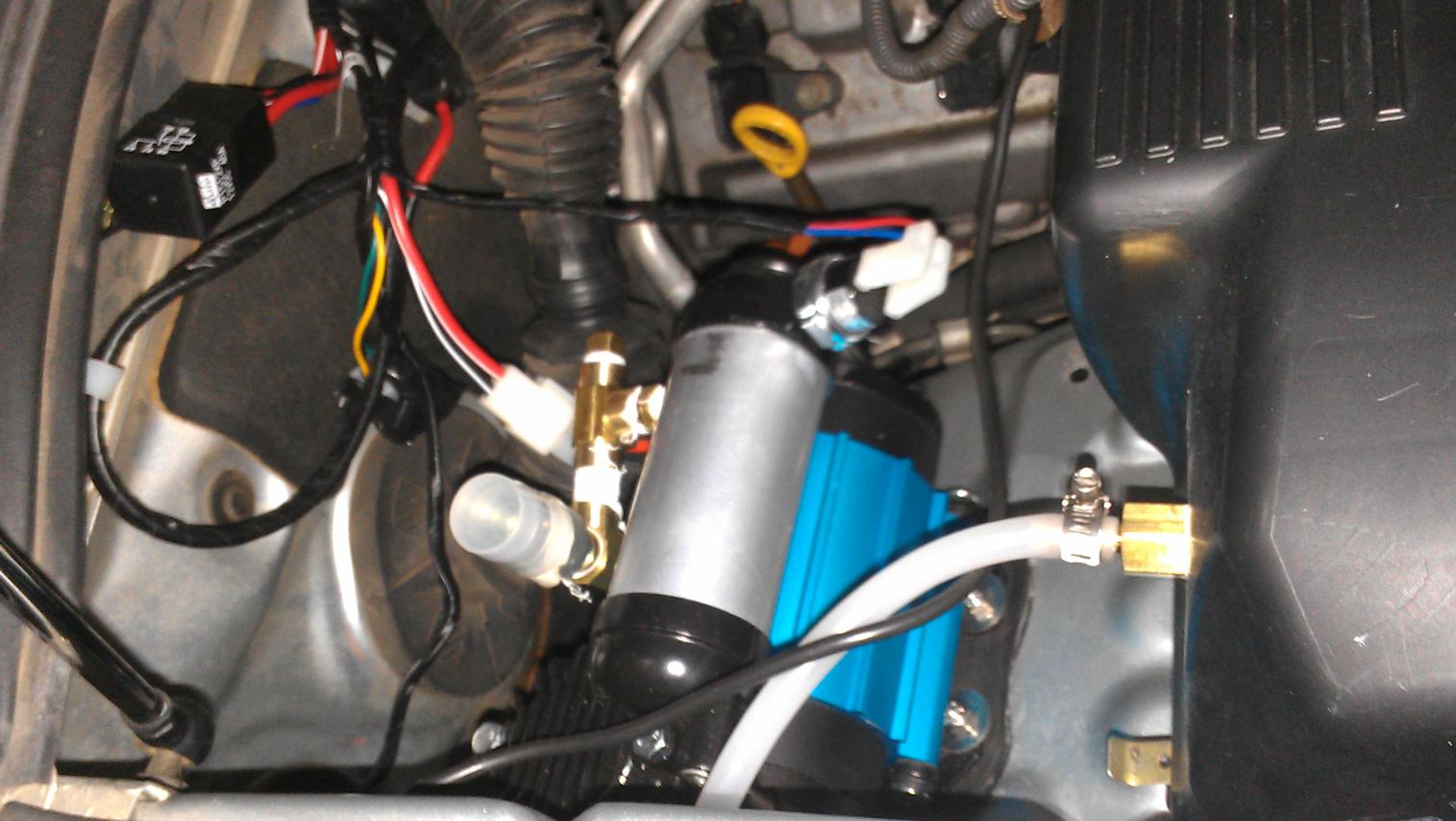

I mounted mine on the passenger side in the engine bay. Ran the air intake to the filtered side of the engine air box.

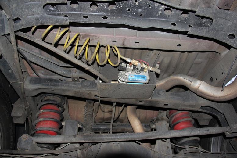

this is what i did, i built the box that it sits in. that is bolted to the frame cross member, and protects the compressor from any damage from rocks or other dangers. then i removed the ARB prefilter, and put in a 5/8 or 3/4 hose barb and then used clear hose(you can see the hose right below the yellow coiled air hose i use for filling tires or my air bags) to run out nad over to the pressure equalization vent in the divers side lower quarter panel and up into the cabin, in behind the rear pillar trim panel. the hose extends all the way up to about 6" short of the roof. this way i am sure it always is pulling clean fresh air even when the compressor is submerged in water of muck. i have had the compressor submerged several times and it has always worked flawlessly for me. and this is what the compressor looks like after 18+months of use. still nice and clean -i do spray it off after wheeling in mud and much and submerging it, but i have never removed it to clean it beyond a spray off with the hose.

this is exactly what i would like to do with mine. So you had that long plate sticking out and the put a big square plate on top of it for the arb to sit on. did you bolt the plate to the truck or the weight of the battery is holding it? Is that a 98? my battery seems to be taking a lot of room, maybe its just the angle im looking at?
