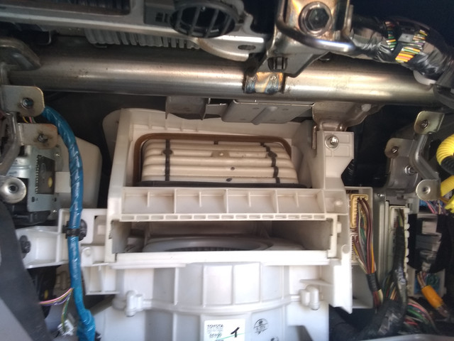

is the main ECU for a 07 4runner also behind the glove box?
is the black square in upper left of pic for the 4wd? and the main engine ecu over on the right somewhere?
