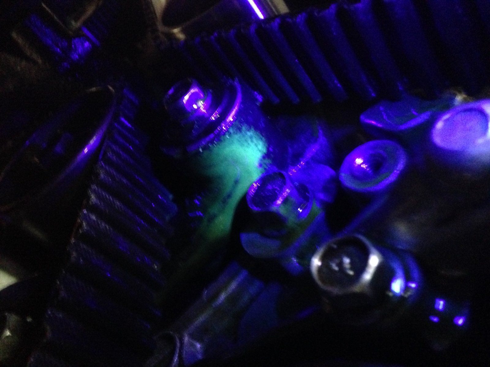

Add some engine oil dye and just trace to its source
I didn't know this was a thing. I just got home from pressure washing/soaping/washing that whole area. If I cant trace it when I take a look in a couple hours (tomorrow) I might just have to do this.

Oh yea takes the guess work out of this entire process
Example of results
photo-2-jpg.284024
I changed my oil several months ago, and several days later saw oil underneath (more than this). Sprayed degreaser wherever there was oil on metal let it dry, then started the truck and saw it coming from the filter. Turns out there was a tiny half-grain-of-sand sized piece of something that was keeping the filter gasket from sealing. Boy, was that a relief! Cleaning all that oil off with the degreaser helped a lot, because it had gone all over the place from freeway driving and you couldn't tell it was coming from the filter.
