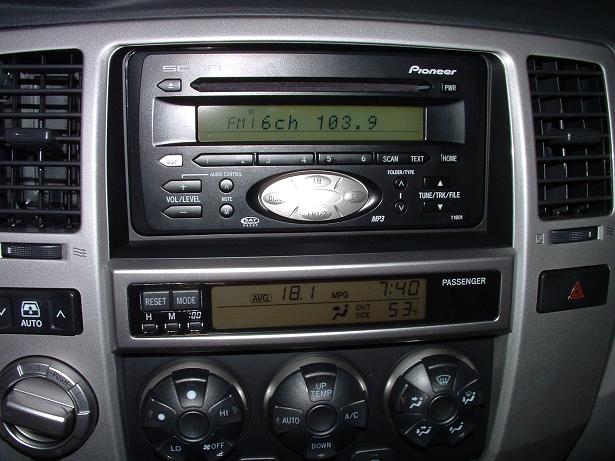

Personally, I upgraded to a Scion Pioneer xB head unit which swapped out perfectly and I can still use all the steering wheel controls. It has 165 watts maximum power so I added some Polk Audio DB series speakers and it sounds real nice and looks like a factory install.

Here's a shot of my Scion Pioneer installed.
Nice!
Very nice Partsrep!
That Scion unit is perfect in there. It's looks sweet, and I like the silver jog / shuttle piece at the bottom. Fancy stuff. Those are high powered units, right?
160 watts maximum output. Compared to aftermarket units I figure that to be around 25 RMS per channel. It really sounds sweet and the units can be had from Scion owners on ebay or Scion forums for around $100.
Did I mention all the steering wheel controls work as they should?

So the Scion radio is more powerful than the stock JBL 10 headunit?
It is a nice install but to be honest, it looks alot cheaper than the JBL 4R headunit to me.
But if it sounds better and has MP3 with 6-disc, it got my attention!
Thanks for posting a picture of it installed partsrep. It is a very clean install.
FYI - The Scion headunit will NOT work will the JBL system.
