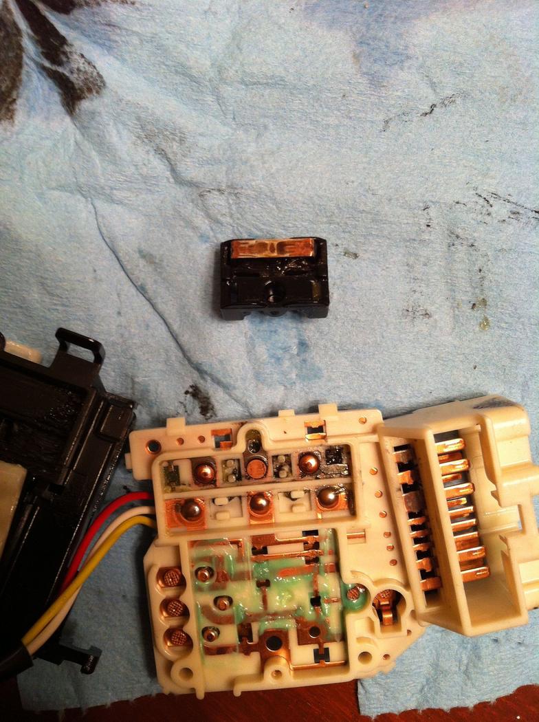

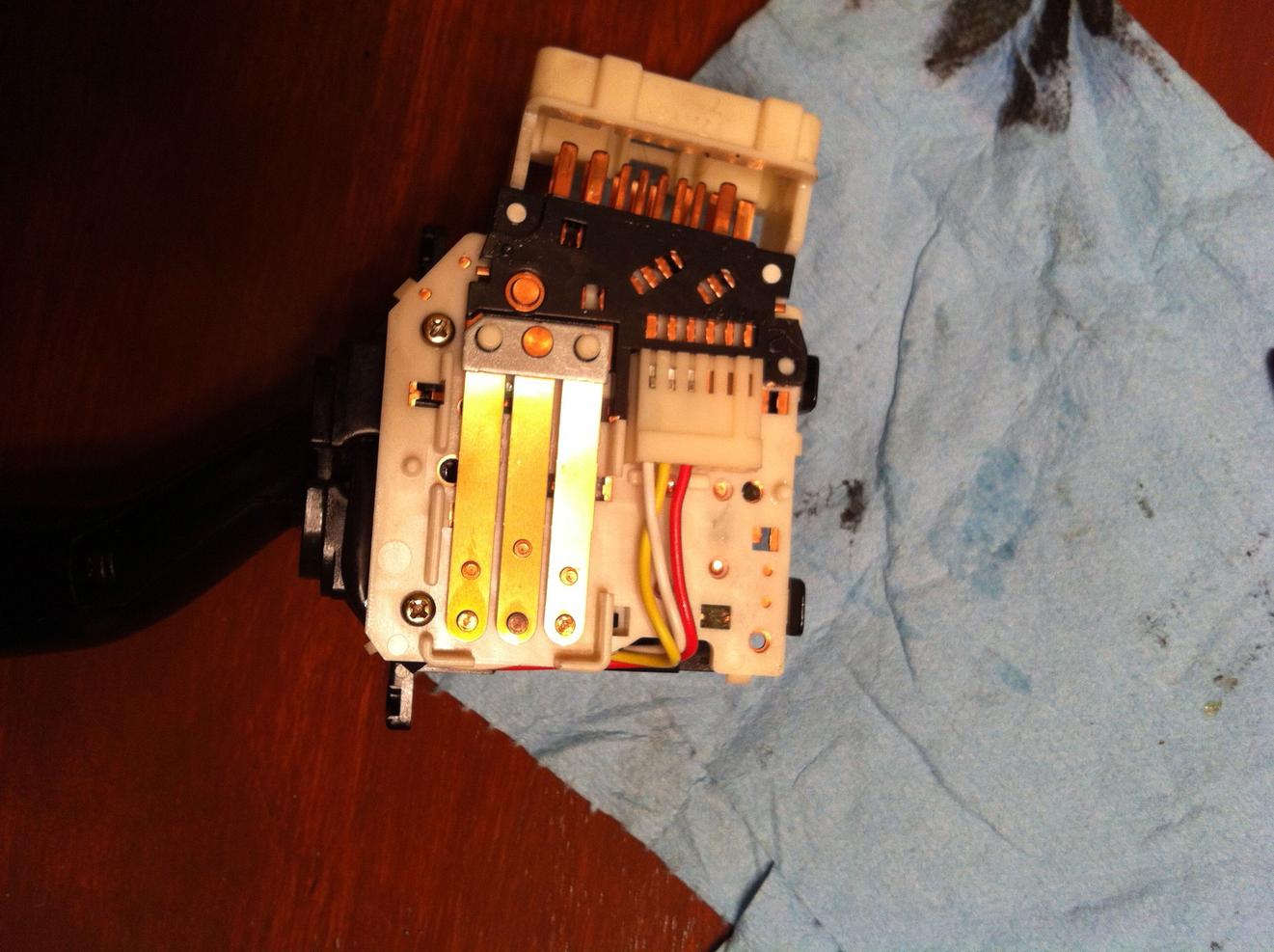

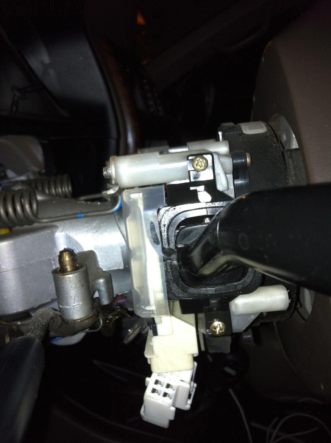

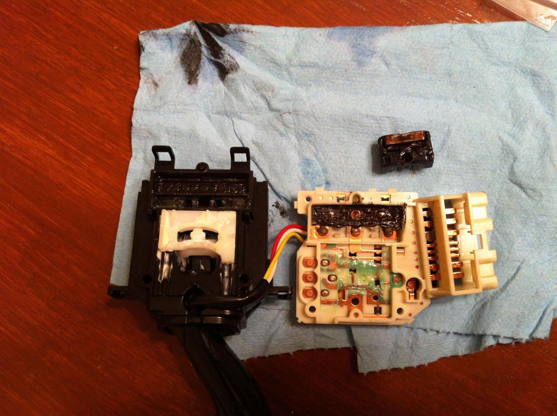

I got a 3rd Gen T4R Limited with 220K on it. I was getting a buzzing sound when I would turn the turn signal on, I could turn it on halfway and not get a buzzing so I assumed it was a connection in the switch.
To fix this you need to take off the panel under the steering wheel (4X10mm bolts). You can just drop this down without unplugging anything just move it down enough to get at the plastic shroud around the steering column. The plastic shroud is held on by one screw on the underside and two screws on the front. The screws on the front can be accessed by cranking the wheel all the way one way then all the way the other.
Once you have the plastic shroud off you can see the turn signal switch, first unplug it from the bottom, then remove the two screws that hold it onto the steering column. You can now pull the entire switch out.
Once the switch is out you can see a clear cover on one side, this can be popped off and is not held on by any screws. Once it is off you can see there are two screws that need to come off, you can then lift the side with the screws off and the other side will unclip.
With this off you can see how the switch operates with the small metal piece sliding between the three connection points. If yours is like mine it is all full of black grease and the connection points are corroded. I wiped it down very well and even sanded the slider piece with some high grit sand paper. Sanding the slider piece is finally what did it, I tried just wiping the grease but that did not solve it. Now just hook it all back up and you should be set! Don't forget to just install the switch and test before you put it all back together :)
DISCLAIMER: Perform at your own risk and PM me if you got questions

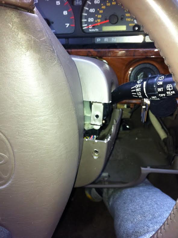

I have a 2000 4runner, and when I turned the turn signal handle to the left, I would hear a buzzing, and neither the left turn lights nor the dashboard left turn lights would not turn on. If the handle was only partly depressed, then the lights would function as normal.
I followed Mikesudyk's post, and my turn signal switch seems to have been brought back to life! However, I experienced a lot of take off the column that surrounds the steering wheel. Most of the top and bottom column around the wheel pop off, but the part closest to the wheel is difficult to reach. I found that by rotating the wheel 90 degrees to either direction (which exposes the screw-hole) and inserting a screwdriver and pushing upwards, I could more easily separate the tabs holding the two columns together.
I unnecessarily scored the plastic around the wheel, but its fixed. The only thing I regret is wiping all the grease off and not applying new grease after sanding down the contacts.
