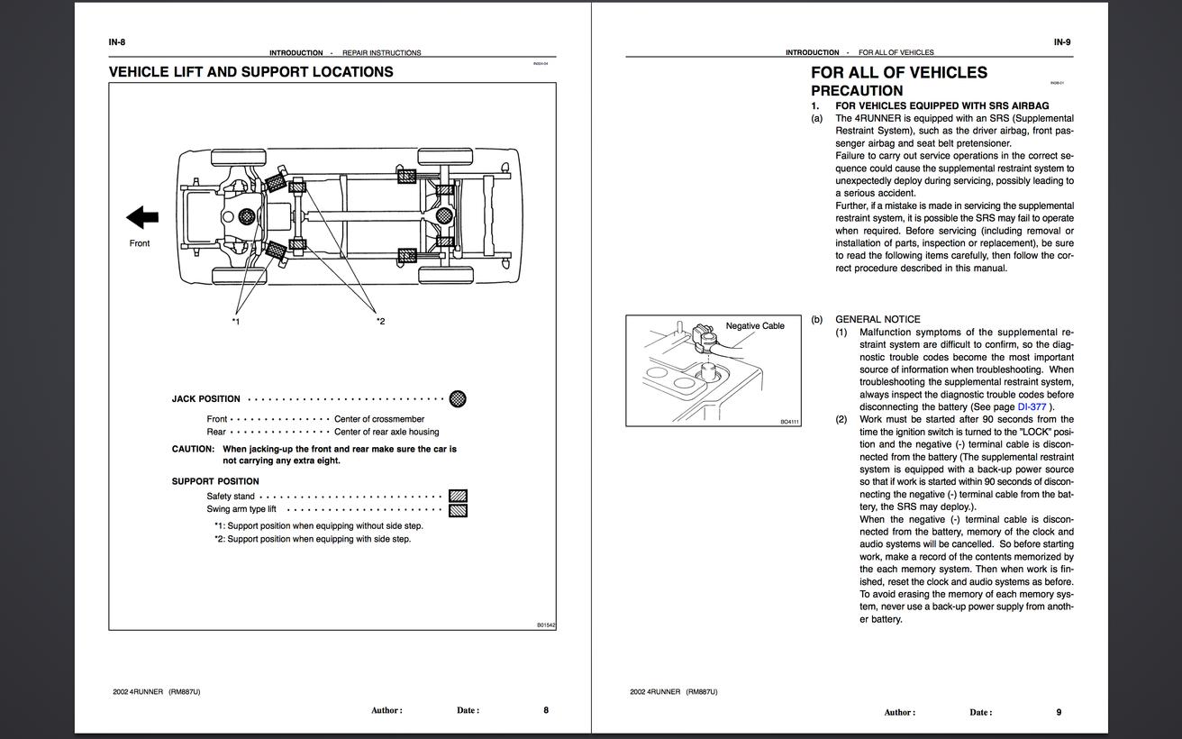

Hey guys, I have changed tires out plenty of time on my Acura TL, but I have never needed to change the tire out on my 4Runner yet and wondering where is the best place to put the jack when cranking it up? Thanks

Not to sound like an ass, but if you have to ask you might want someone actually show you, rather than trying to gain a description off a forum.
Like above says, the manual is quite explicit.

Yeah, that manual snapshot explicitly says to make sure the vehicle is not carrying any extra eight so take out all Spanish coins you have in the vehicle.:rofl:
On the front you can put a jack directly under the a-arm so that all movement of the jack results in movement of the tire off the ground.
With the jack under the frame or front crossmember the tire doesn't start to come off the ground until the suspension reaches full droop.
