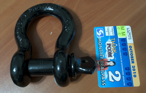

I have seen winch shackles at Tractor Supply, if you have one near you. Saw various sizes last time I was in there.
brianemc2 those were actually a set i was looking at they seemed to be pretty good quality and a good price, if not ill look at a tractor store! thanks
