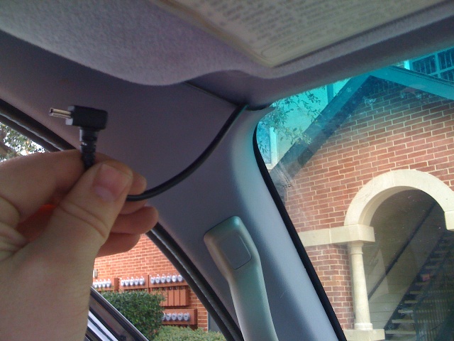

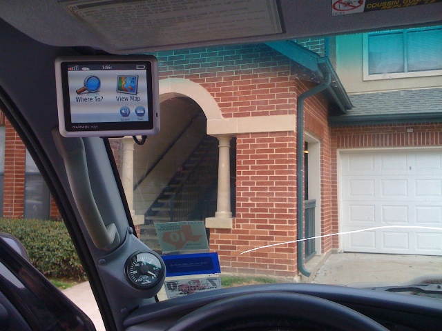

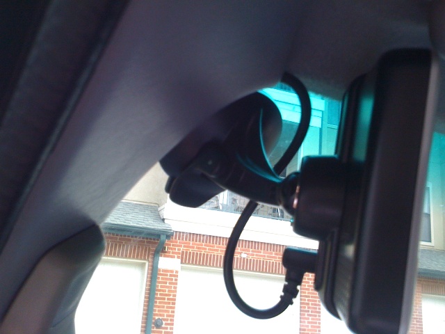

I mounted a 12V cigarette lighter under the dash, near the foot rest as the power source; cheap and easier than hardwiring. Mounted the GPS on the top of the windshield as the pictures show and ran the wires down the pilar.

I have mine located in the lower corner driverside. If you look at JSMarine pics it would be where his Texas vehicle inspection stickers are.
Mine is mounted just like JSMARINE did. I ran the assy. socket to ignition power so it turns on when I start the truck and shut's off when I turn the truck off.
