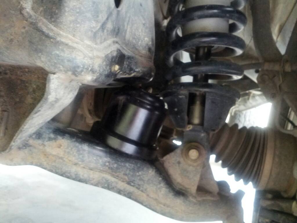

Wheelers 2nd gen super bump stops. In the rear I'm going to make a custom bump stop extension and use the same type in the rear.
They are super soft. I can compress them with a finger. The up travel is the same as stock. They compress down to less then half the size you see there. I love them. I was considering air bumpstops but I'm going to run these for a while.
