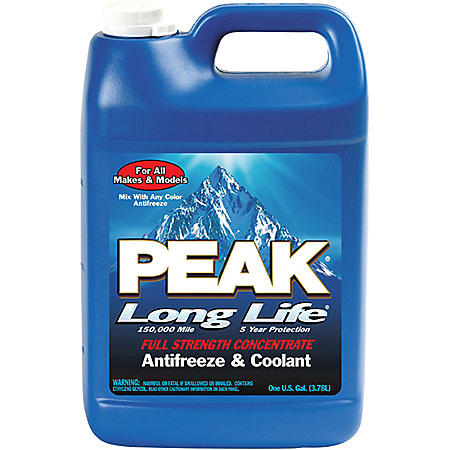

This is what I used...The autozone guy told me it was good?
They design their coolant to resist corrosion in the exact aluminum mix of the engine metal.
Correct...and the company that makes it for them also sells it to other companies to sell under their brand name.
Wrong. The exact blend is copyrighted and patented to Toyota making it illegal to sell it under any other name. Aftermarket is NOT the same.
EXACT formula...probably not....Equivalent formula that will work as well or better YES.
Several companies sell this.
Then to add a caveat....GM has several vehicles with Toyota engines in them...In fact some of these engines are shared among GM and Toyota...Toyota puts in their Pink formula...and GM puts in their Orange formula. This has been going on for years with no ill-effect what-so-ever....so OBVIOUSLY there are compatible formulas that work.
