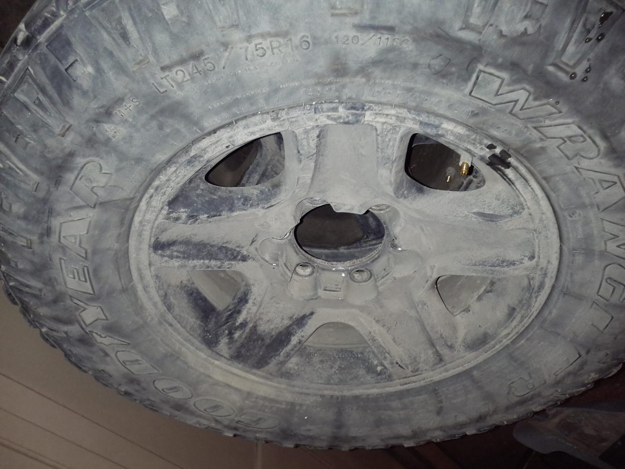

which lugs with these wheels?
SLEEPR
Picked up some limited 5 spoke wheels, but buddy didn't have lugs. Which kind do I need? I've seen some with attached washers, others without.
just the standard lugs, not sure how else to describe it.

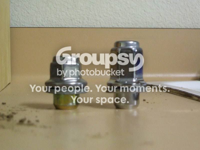

I've used stubby oem lugs that come on the newer 4runners and normal ones on many oem wheels and they worked fine. Given that fact that your wheels are ones that come on a lot of these gen 4runners specifically means you wont have any problems if you just get the oem style ones. The thread engagement depth on both styles are the same. The only difference is the socket length engagement. See picture.
Stolen from internet
02-1.jpg~original
Secondly, Toyota uses these lug nuts across many of their vehicles (call it simplicity). So, many aftermarket OEM style lug nuts are going to abide by that platform. If it says Toyota OEM style lug nut it will fit A LOT of other Toyota's, and in this case, the wheels in question as well as your 4Runner.
