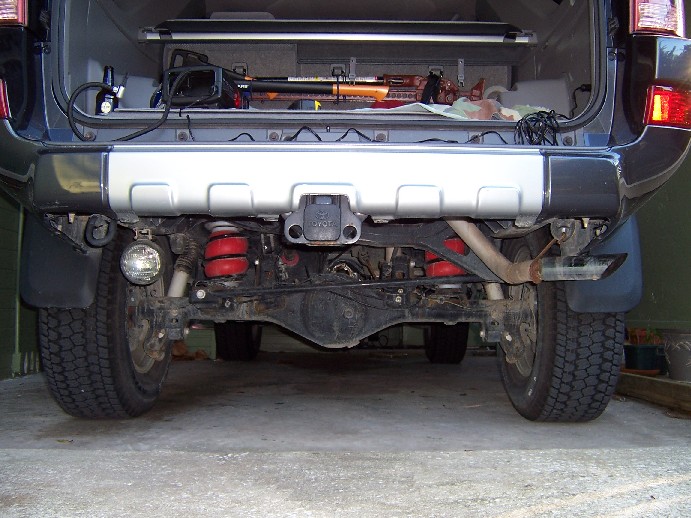

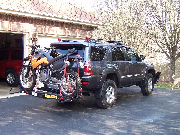

Here ya go! Goodyear ATS's - great tires -so good I don't carry a spare. Perfect size - only a slight drop in MPG, can't tell much loss of power. I think it you go 285 you may see some more loss and not much gain off road. You can see I have the KTM on the back, Thats a good 300#'s including the hauler. I run a set of air bags in the rear coils to avoid the sag. You can see it's pretty level. Before them the lights were in the trees under load. Great $100 mod. I also have the Revteck 3 inch coil spacers. Hope this helps.
Colemanfu -
How's your ride when it's empty? Has it turned harsh?
The Revteks are 3" front and 3" rear, right?
Not harsh at all. I take most the air out of the springs when unloaded. If you run unloaded with anything more than 15psi tils like a rigid. The lift had no difference - just about like stock.
