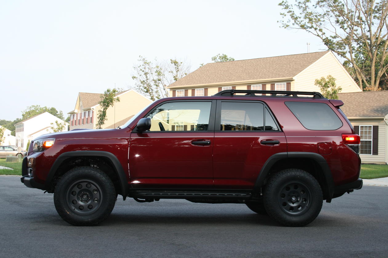

Had mine at .85 but changed to 1.75.Just finished the install and waiting for toytec spacers for the rear.85 will look good and fix all other issues if you plan to keep the rear stock.On the other hand i'm not sure if you like it at 1.75 with stock rear coz i have a reverse rake on the side view.heres a pic of mine at .85 with stock no load rear.Thats taken from a level ground.at this angle i notice a reverse rake with the billys at .85. IMG_6978.jpg

Wow -- that's some major rake. This is at .85 or 1.75? I have never heard anyone complain of reverse rake at .85.
Do you have KDSS? I would think KDSS would bias more weight to the front.
Well that definitely rules out option #2, I guess.

Had mine at .85 but changed to 1.75.Just finished the install and waiting for toytec spacers for the rear.85 will look good and fix all other issues if you plan to keep the rear stock.On the other hand i'm not sure if you like it at 1.75 with stock rear coz i have a reverse rake on the side view.heres a pic of mine at .85 with stock no load rear.Thats taken from a level ground.at this angle i notice a reverse rake with the billys at .85.View attachment 48246
That pics is taken at .85 bellstein setting.No i dont have KDSS.maybe thats why i have the reverse rake.I should have bought from amazon.I got mine from toytec and its $50(including shipping) more that the amazon price.Thought ill try it out with the spacer and if i like the stance then ill save some for the SAW 1.5 springs and a pair of shocks.Im not gunning to for a real level set up but would like to keep at least an inch rake.
The KDSS probably does make a little bit of difference - I'm sure the thicker sway bar alone weighs several pounds more than stock, not to mention all the hydraulics.
Is it possible that your spring was installed incorrectly on the perch? I've read that accidentally reversing the perch can boost the lift.
If you have the chance to post a similar shot with your truck at 1.75, I'd appreciate it. Would be interesting to see the difference.
I think a lot of guys are leveling-out the top of the wheel-arches. I agree with you, I think frame-level is the way to go. Therefore, .85 is really the only option if you leave the rear stock. BTW, did you measure before/ after? did you get an actual lift of .85, or more?

I marked the springs and the color(green and orange) marks aligned facing the front of the truck.I'll be taking pics this pm and post em.
+1 on the frame level. yup i did get +-.85 at that point.
It's interesting to see that your gallery pics all look completely level. I can't imagine a 1.75/1.5 lift would result in a negative rake though - if anything, I'd worry about there being too much lift in the rear. Other thing I worry about is the 265s looking a little small.

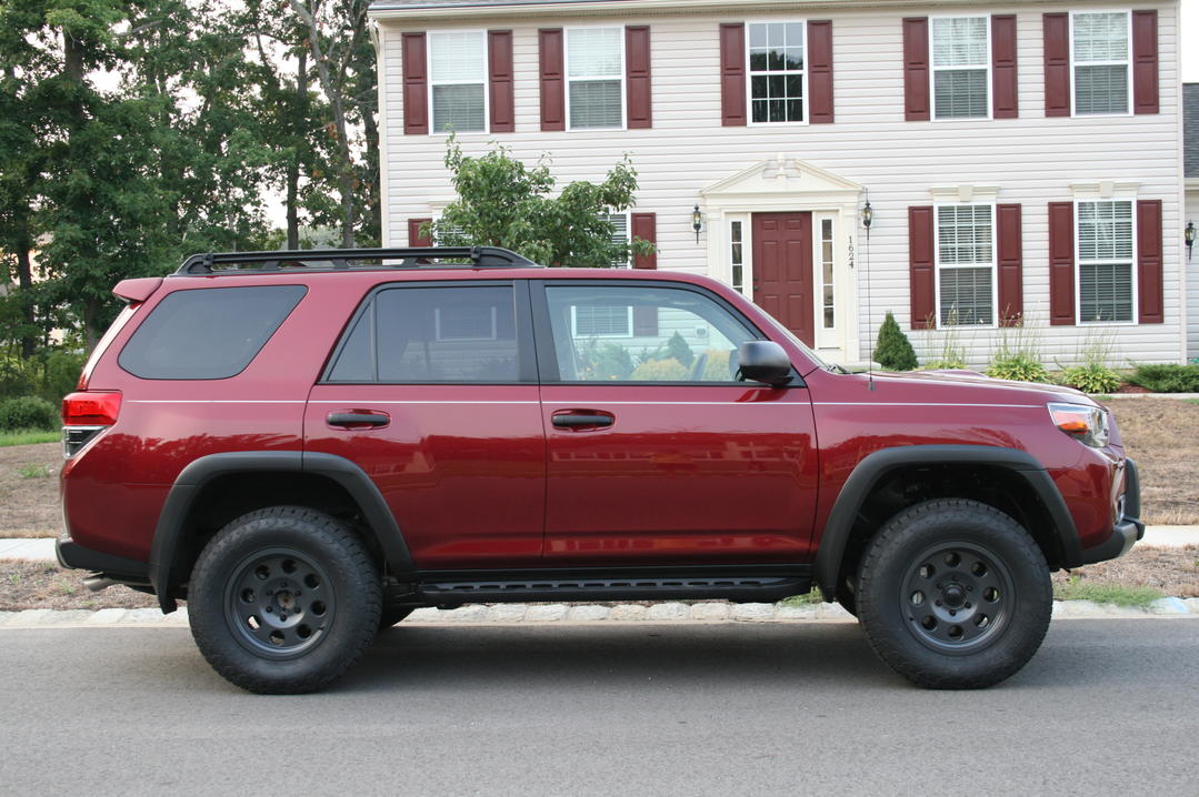

Didnt drive it on the main road yet.but i see the hood. Lots of hood.might have to wait till the rear spacers come and have the alignment alltogether. Thanks.
Bastangs photo at .85 makes me nervous to put mine at that when installed next week, looks like reverse rake, yet seems like everyone else has been ok, but a couple (small handful) seems like back is lower at .85 in photos but they say it measures out ok....anyone have any other in put? Mike g looks good at .85. Wonder if it's not doing the rear with 5100 (even though it's not suppose to give you any height at all). Can't be tires.... Should I be concerned, I do hate reverse rake.

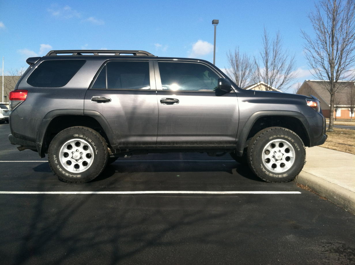

I have mine set at the highest setting with 1.5" rear coils. The tires are stock size.
