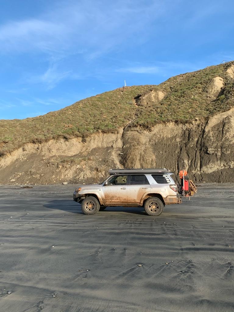

After monkeying around with different rear springs over the years I’m super happy with my OME 899s. I’m a similar weight to where you will be at and I wish they were a little stiffer to be honest. When I’m fully loaded I even turn up my rear compression dampening pretty high to stay off of my bump stops when moving briskly off road.
Here’s how I sit fully loaded with about two weeks of food and water loaded up. The front end is a bit low because I adjusted them down before this trip.
I run Bilstein heavies and happy.
Proline bumper, dual swingouts, dual cans, Dometic fridge, RSG plate sliders, RCI Steel skids including tank, Rhino Rack Pioneer platform and full sized batwing, Thule XT Pro bike rack and A Cannondale mountain bike. I also have an APOC steel expo trailer - zero squat
