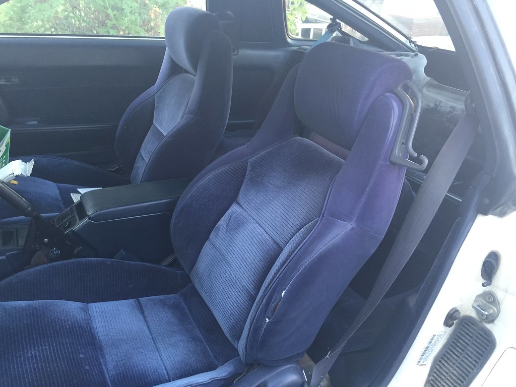

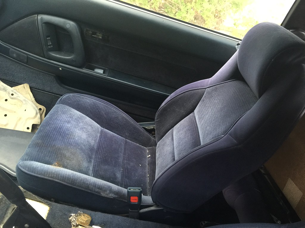

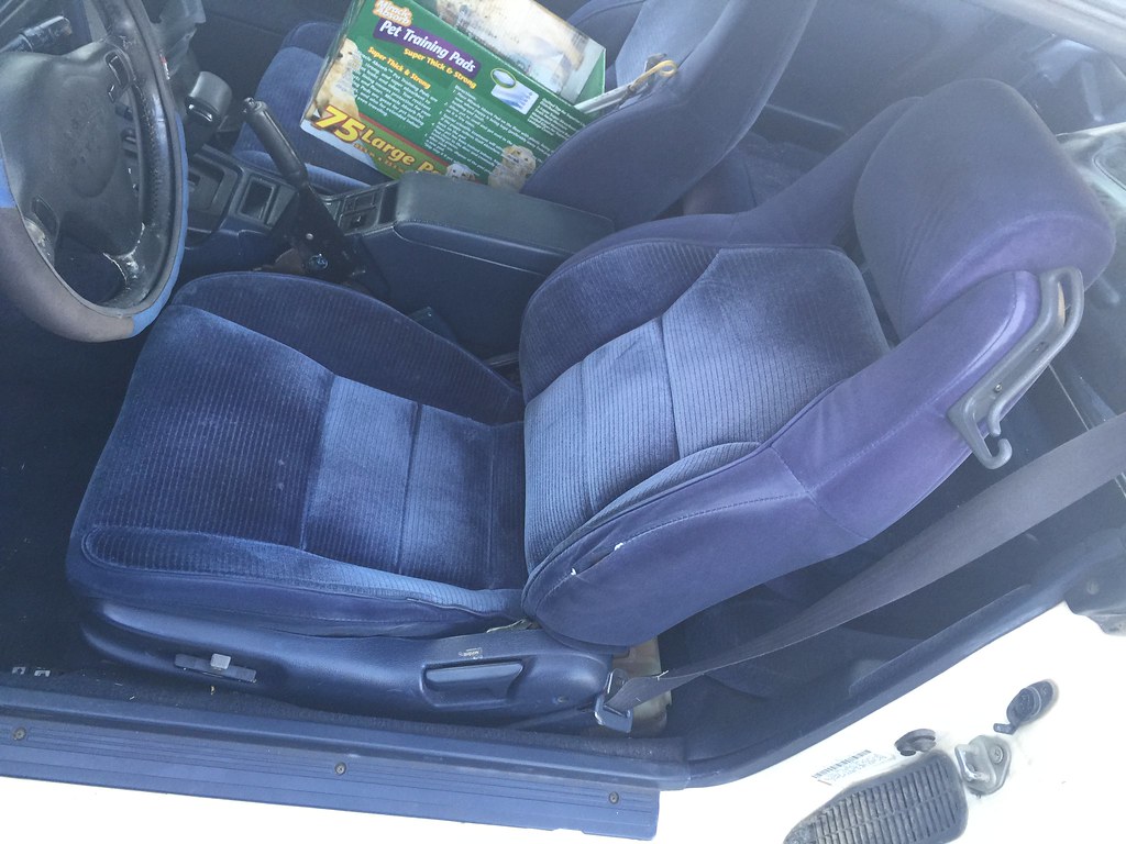

I have a set of MKIII Supra seats I was thinking of trying out in my truck.
Driver's side is power, 12 way adjustable, comfortable as hell.
Just gotta dye them black. I read that the front bolts fit in great and that you just need to drill a couple holes for the rear bolts to fit.
Passenger side also slides forward for rear seat access

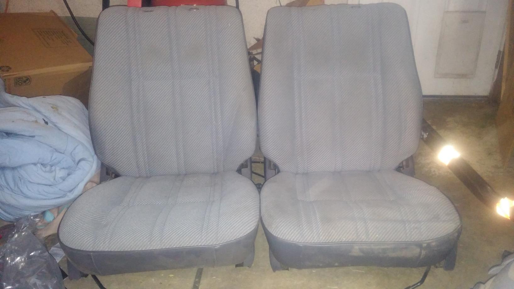

91 seats for free

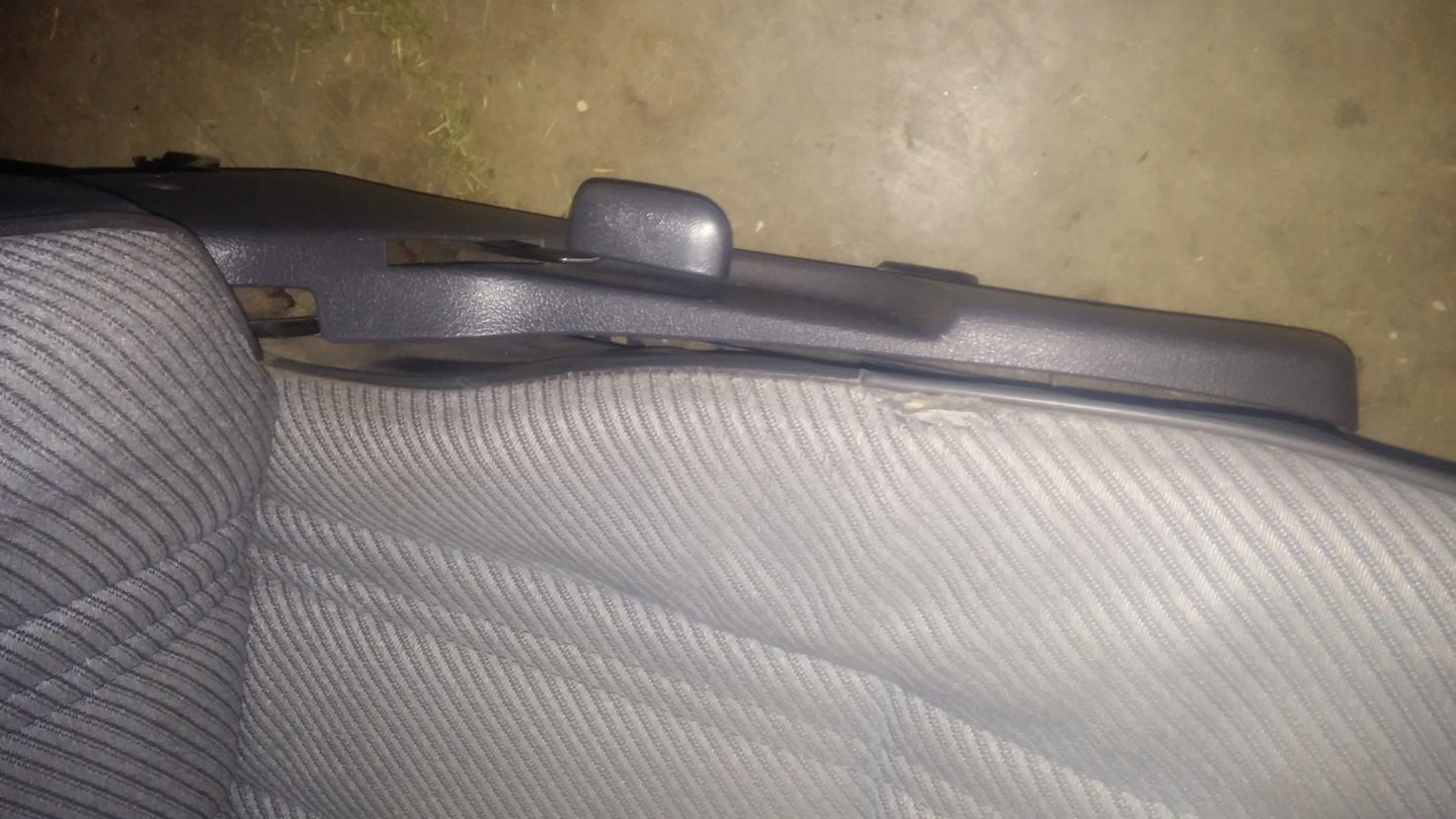

There is wear on the drivers side side. But the price is right:guitar2:

no PM yet
Hello Will, Willy here I am two miles north of the ten off Cedar.. anytime in the afternoon or weekends. Haven't received a PM yet
