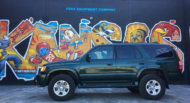

Let me know, I would've thought the rake on the lowest setting would be too much but I'm curious how yours look. Mind posting a pic?

Sorry for the late reply, man. These past few days were kinda hectic and we're fighting some winter weather. I will get those measurements this weekend!
Pic of my truck at the current height with the aforementioned suspension setup:
Also worth noting:
-rear tow hitch is mounted
-spare tire is not mounted
-no trim packers or spacers installed
-no additional weight in the trunk
The instructions that came with my bilstein shocks showed first notch, stock height, and each higher notch added about 1/2" or so
Personally I think the truck looks better with the running boards/body level and the empty space in the wheel wells above the tires about even. Too much rake looks wrong on these trucks.
