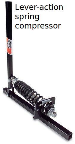

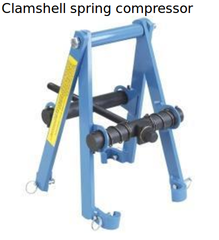

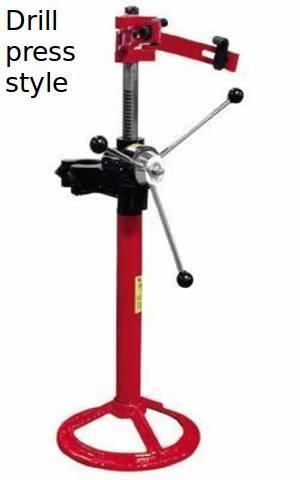

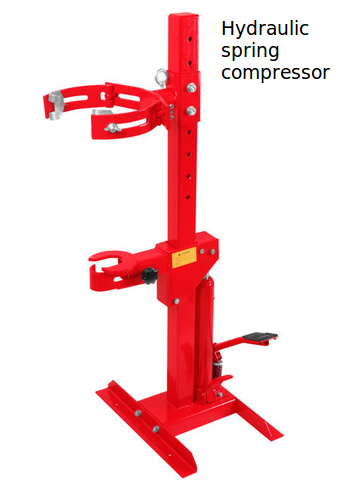

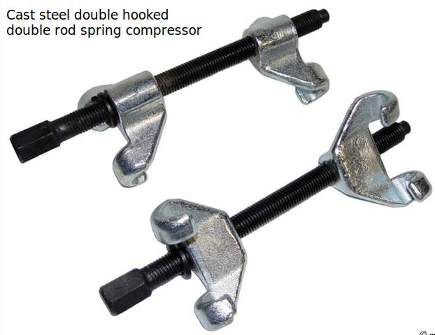

Which style of spring compressor do you recommend using for a 3rd-generation 4Runner?
Status
Not open for further replies.
mom
Banned
I busted my front shocks & therefore am in need of a spring compressor to replace my Tokico GU3564 front shocks (Toyota P/N 48510-39406).
Googling, I find a plethora of styles to choose from, at a huge range of prices, from $20 (which seems too cheap) to $250 (which may be too expensive).
Since compressing springs could be dangerous, but, you guys do it all the time, may I ask which style of spring compressor tools you recommend using for a 2WD Toyota 4Runner?
Note: I wasn't sure of the names, so, if you know the 'real' name of each style, that would be helpful to both me and to others in the future.

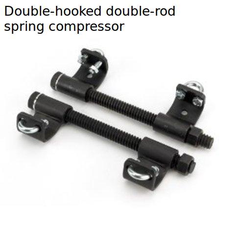

I rented for free some spring compressors from Auto Zone (just leave a $50 deposit that they refund upon return). They worked great. If I remember correctly, they had a feature on them that helped prevent the spring from coming out while compressing.
In the link above, when you click on steering and suspension you'll see the tool that says "strut spring" (for MacPherson strut springs). That is what it looked like.

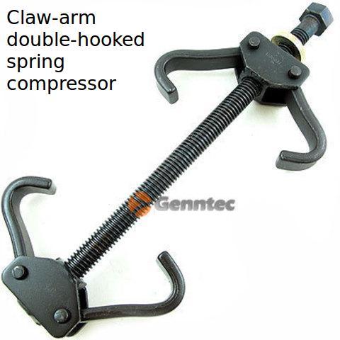

I used the claw arm style on my Tacoma years ago as it was all we had. When I did springs and shocks on the Runner I used a wall mounted hydraulic unit. Both did the job just fine, but the hydraulic unit seemed much safer and easier.

A number of people here have expressing feelings that the threaded types are pretty sketchy when they get some tension. That said, a couple guys have used them successfully too. If one of the other options are available, I'd say go for that. Compressing these things will store alot of energy; you don't want to have misgivings about the tool containing it.

Anyway, with both AutoZone & O'Reillys lending out the bolt-and-claw style spring compressors ($50 deposit), one simple option is to order the shocks online, and then when they arrive, get both sets of spring compressors (one from O'Reillys, the other from Autozone) so that I can at least put three (and maybe four if they fit) of the bolt-and-claw types on the spring (for safety).

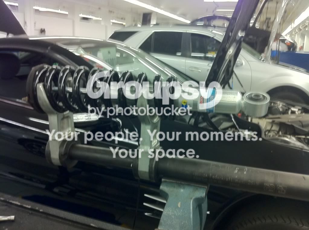

Check around at a independent shop. They usually are better about bringing in your own parts and most will do the job for around $50. A wall mount strut spring compressor like this:
are the best but they are like $400-600.
The bolt style that you rent:
will work fine too but they are not as safe as the wall mount.

I tried the loan a tool program one from Advance Auto and they were bowed out before I could get them 1/2 way compressed. So I'd strike that place off the list.

I used the ones from autozone, and they did just fine. A little bowing didn't ever hut nobody!!!
Just kidding. They really didn't bend that much.
I just did mine yesterday and used a Branick wall mounted unit. Easy and only took a few minutes. I would seriously avoid any of the "threaded rod" type as the front 4Runner springs are pretty serious units compared to most strut-equipped vehicles. Most small garages can do them in 10 minutes and for $20-30 its a bargain.

I definitely think it depends on the exact ones you find when it comes to the threaded rod kind. I used a set for my 2001 TRD Tacoma Doublecab (if those aren't stiff springs being a progressive spring, I don't know what is), and compressed the springs enough to get them on the highest setting for some Bilstein 5100's. I still think the general consensus is to take them to a shop and make it a worry free job.
Threaded rod type works just fine..AS LONG AS YOU USE IT RIGHT..
I decided that I'll replace my Tokico shocks by borrowing TWO spring compressor kits (one from AutoZone, the other from O'Reilly).
I'll put at least three of those threaded rods with hooks on the truck spring, the additional rod, for safety.

I did used that tool in the past but that was before we began to dismantle struts like ours. Since then we use the one bolted to the wall. The first time we used the tool that Toyota suggest on a runner strut, we broke 2 different tools on the same strut and we had to bring it to another shop to do the swap for us.
I bought some cheap harbor freight ones....they just bowed, the spring didnt even compress. I took them to midias paid the guy $20 to assemble them and i was one my way.
When I did this I bought a hydraulic one from Northern Tools on my credit card, used it, returned it the same day and got every penny back. I've actually done the same thing for a number of expensive one-time-use tools.

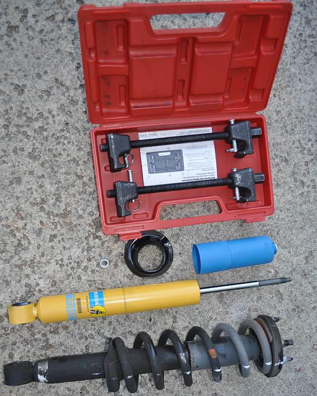

To close the loop, I finally bought the Bilstein shocks and rented (for a $50 deposit, good for 90 days) the free spring compressor tool from Autozone.
