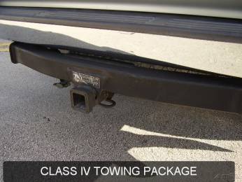

does it look like this

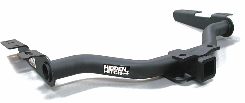

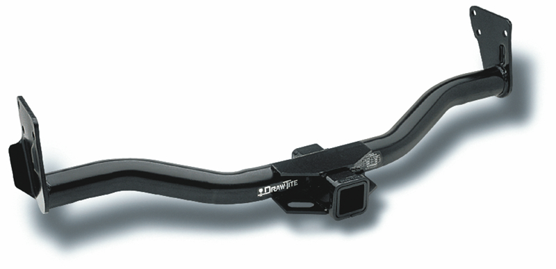

Anyway I'm still trying to understand the hitch below the crossmember thing and hopefully some photos will get me straight. the first one below is a bent one from cequent and doesn't appear to have any drop and the second I pilfered from ebay which looks aftermarket and with a drop. Can't seem to find any pics of OEM hitches so any help is appreciated. Going back to my OP I thin the curved round tube looks the best ?

The picture on the right is the OEM hitch.
From my look at the websites, all of them indicate the picture might not be the exact one. In my case, the Drawtite that showed up is a beefy one, with the end of the tubes caped. Not the one pictured in this post, or the other post following it on this thread. Raining here, or I would post a pic.
