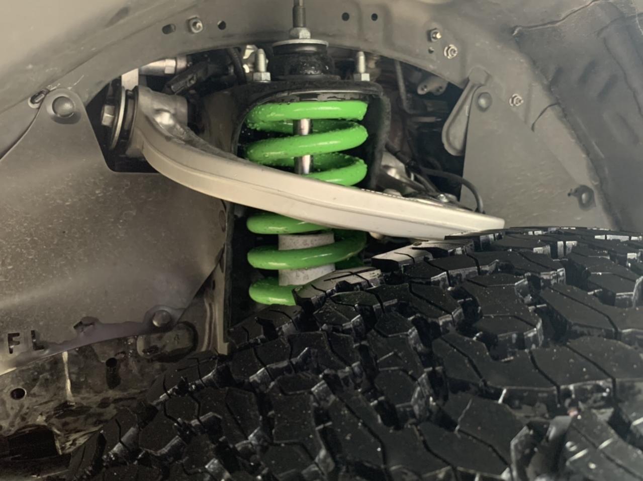

I was close to pulling the trigger on SPC, Bilstein and OME. After more research, ended up with Ironman Nitro stage 2 kit. The forged UCA is beefy and uses OEM ball joint & bushings. For my 95% on road and light off road use, it was a great choice. No rub on UCA with TRD OR wheels and KO2 285 70 17 load C’s. After 6 weeks, I’m very satisfied. At under $1,200 for the full kit, it’s a bargain lift option.
