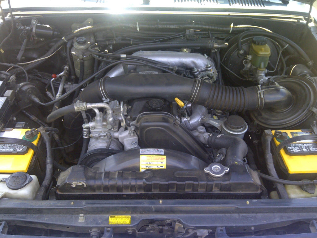

All this discussion is making me laugh. I have a 1995 Toyota Turbo Diesel (2.8 liter) in my 1993 4Runner 4 x 4. I'm the original owner of the truck since it was new and the diesel swap was done by an excellent custom shop several years ago. It is a left hand drive, so I don't have any of the RHD issues. I feel I can speak about it with authority, including the biodiesel comments. Overall, 1993 4Runners were not known for great torque. The diesel changed everything. True, it sounds a little different than stock, but the Toyota diesel is very quiet compared to Cummins, Fords, Chevy etc. About the only one quieter is the Mercedes. Biodiesel is not corrosive to metal, only to certain pliable materials. To counter act that, fuel hoses and the like were replaced with Viton material. I've used biodiesel at times but never SVO. I would strongly recommend you drive mine and see how you like it. It looks completely stock and blows people away when they see the engine compartment. It is smooth, quiet and pulls quite nicely. The auto transmission has a selector switch for towing. I drive this vehicle every day. I've got a class three hitch, TJM bumper, turbo boost gauge, 4 point harness and head rest for the middle passenger in the rear seat and suspension improvements over stock, but that's about it. The interior is stock and about the only thing a sharp person will notice is a factory idle up switch and a little "diesel fuel only" sticker under the speedometer. Speedometer has miles per hour, just like stock. Fun to drive and always makes me smile.
My motor
Hi, this is a kzn130, so the model code is y-kzn130w-gkpqt. It is stock with the factory turbo. It came from a 1995 HiLux Surf. How's it going in the Great White North? What's the deal with adding photos? I seem to be having trouble so perhaps file size is the issue.

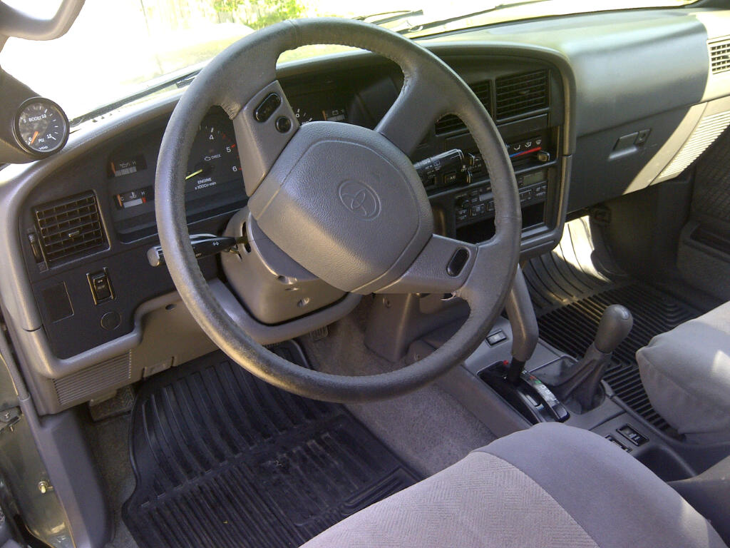

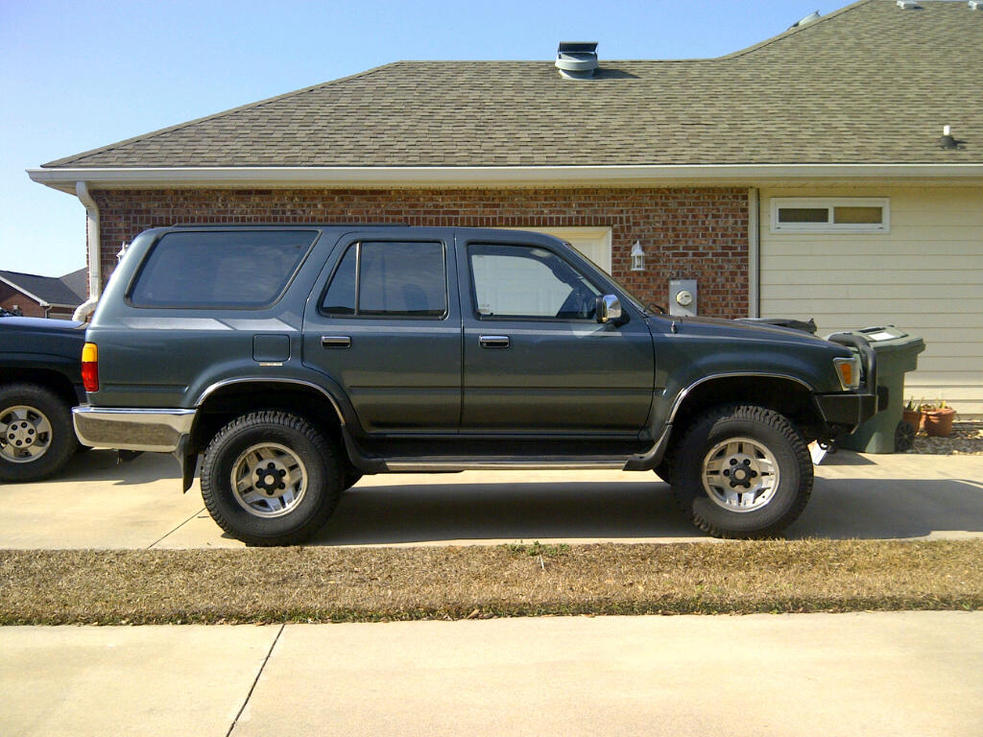

Photos
Here you go. Look familiar? I was fortunate to go to Japan a while ago and was able to drive around the country side. Everywhere I went, I saw vehicles like yours with the side view mirrors mounted up front.
Scott
