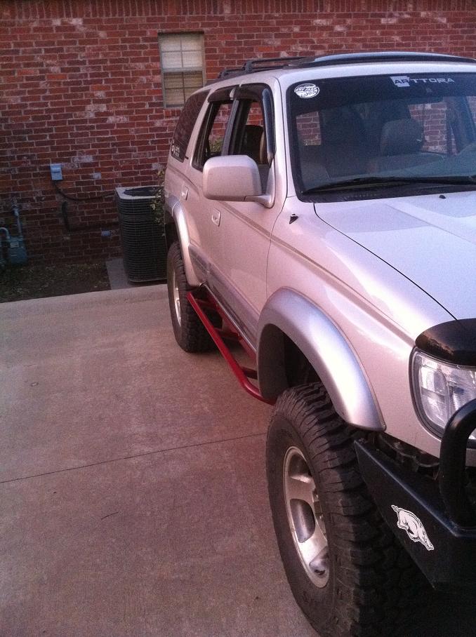

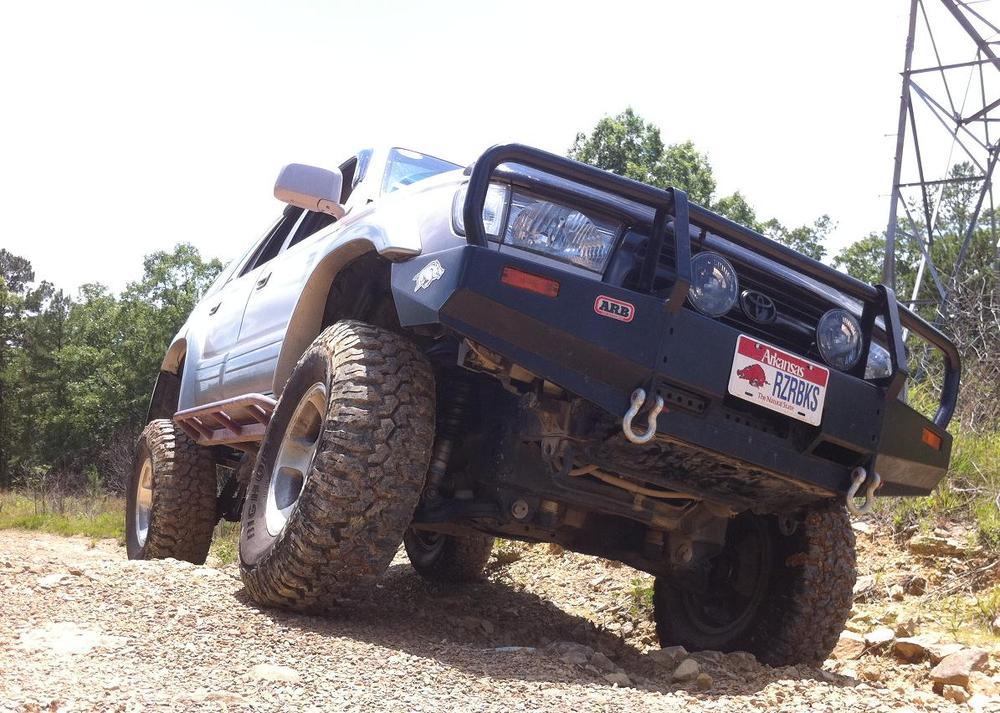

mine are custom.. reason being, not a whole lot of companies make them LONG enough. I've seen anywhere from 63"-67" while mine are almost 69". They also don't just tuck up on the body like you see most of the time, I can actually lean into a tree or rock mid body and not have to worry about it being so close to the body. They've done more than a fantastic job holding up and I've already put them to the test a couple times. The hybrid style (square tube running along the frame and round tube coming off of it) makes for a great look I think.
I think they cost me like 125 bucks, mounted. Somewhere around there.
