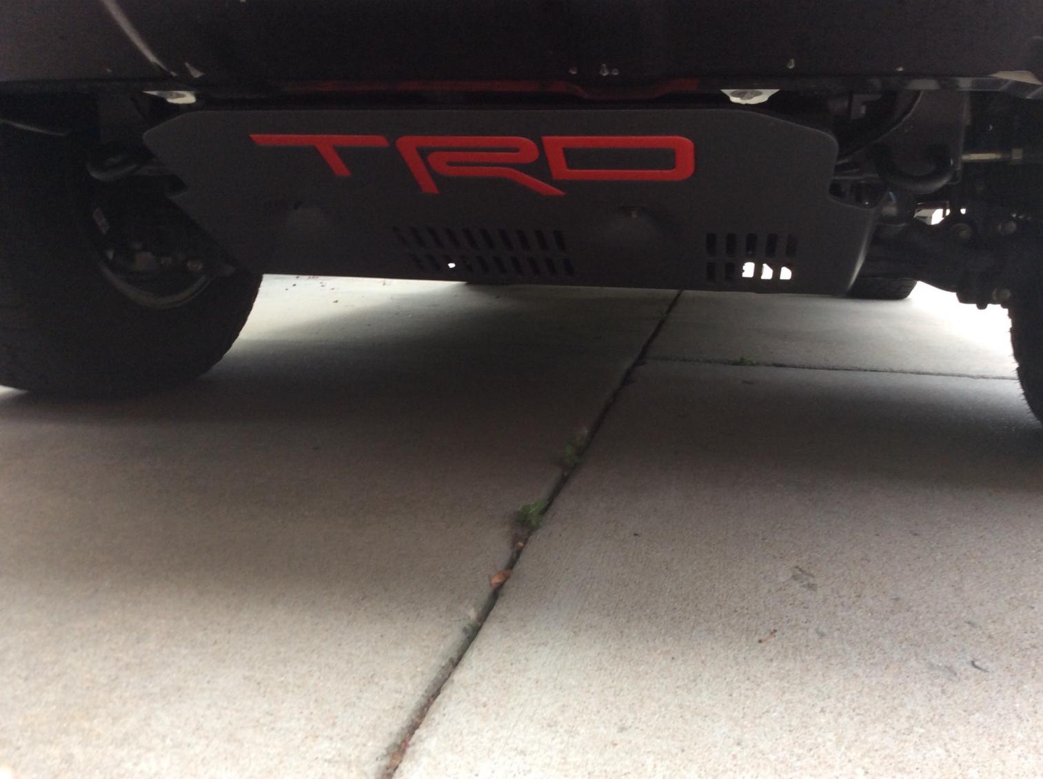

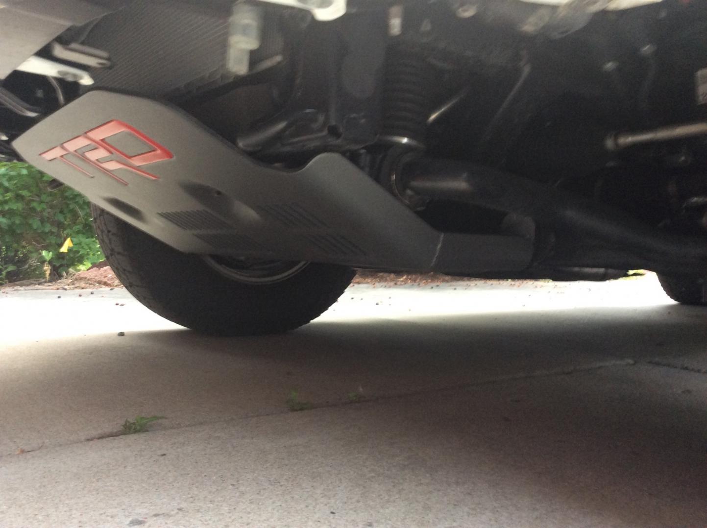

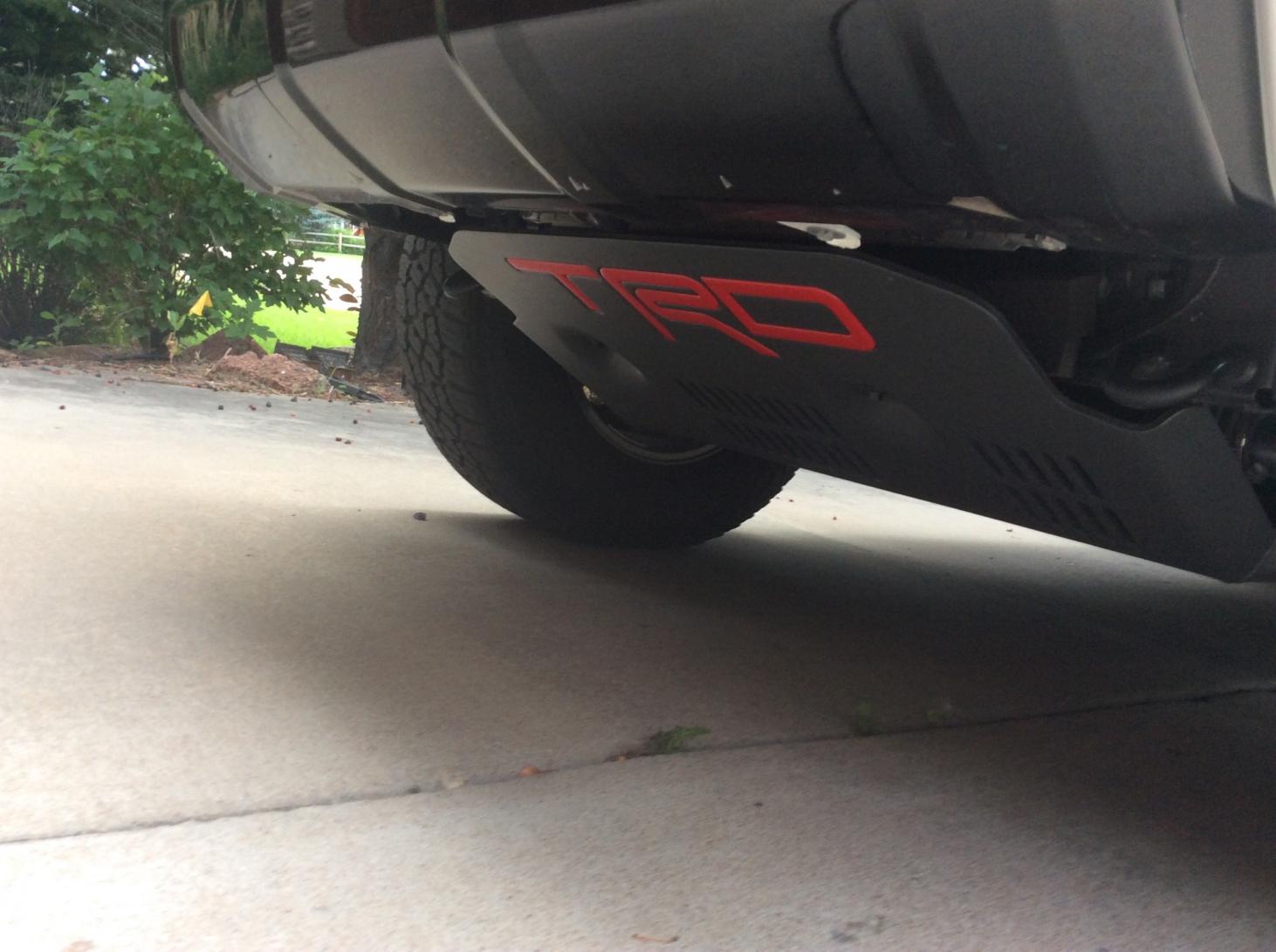

Forgot to add price. I paid $150 for the TRD skid and all the RCI skids including the fuel tank skid.
