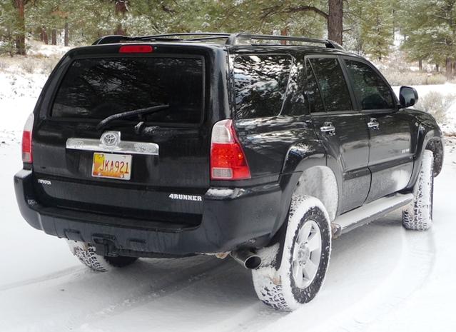

There are no companies that I know of offering what you asked for. There are a couple companies that offer a cat-back exhaust that routes it out the side. Just find a muffer shop and have them do it. I used a section of the down-pipe from a Ford powerstroke diesel, a long 9/16 u-bolt left over from some lift kit, and a magnaflow tip from a cat-back exhaust that was never used. I did it myself in about 45 min. Sorry not the best pic.
