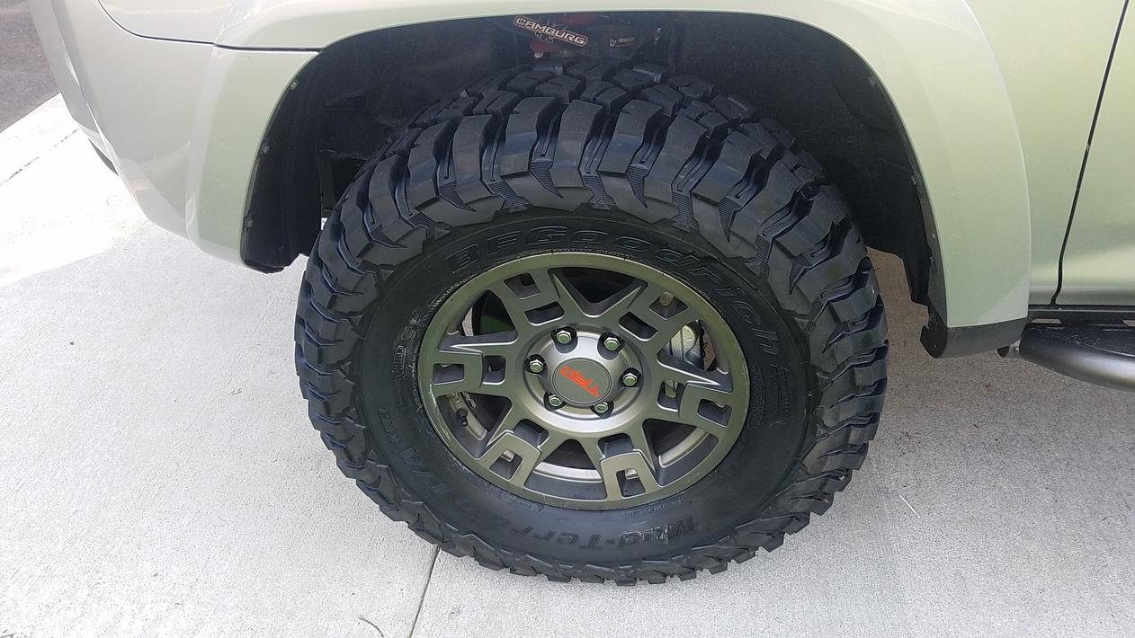

285s are fine on Pro(Sema) wheels.

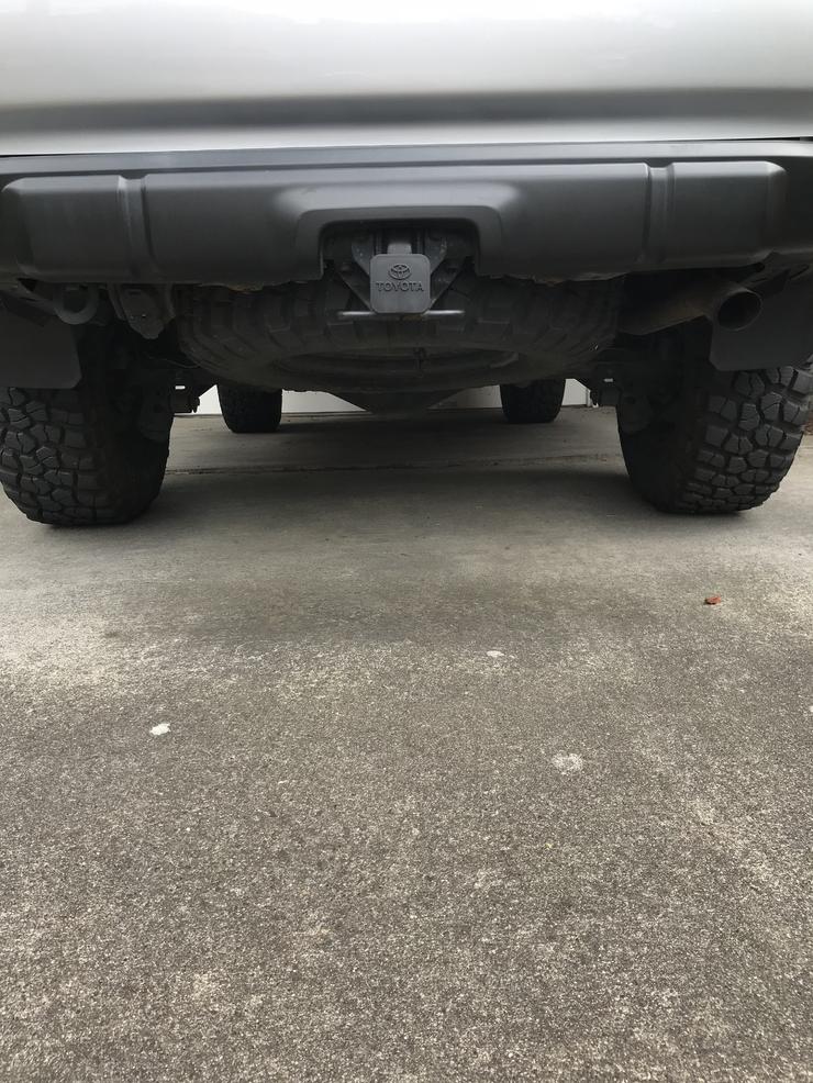

I run the 285s but I use the 255 as my spare. It works well because of its thin profile it doesn't hang down as much as a 285 would. In the event I need it, I will still have a 33" tire.
