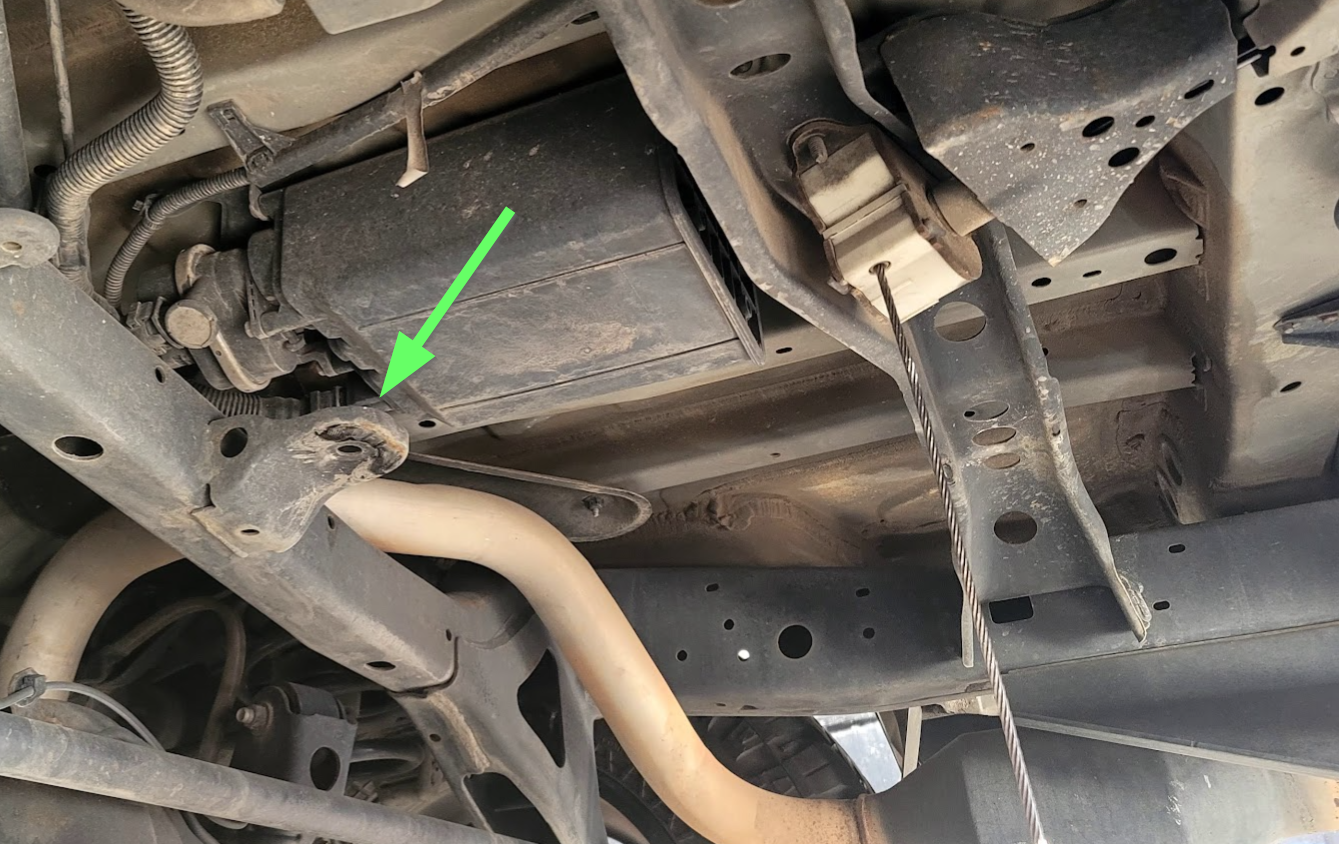

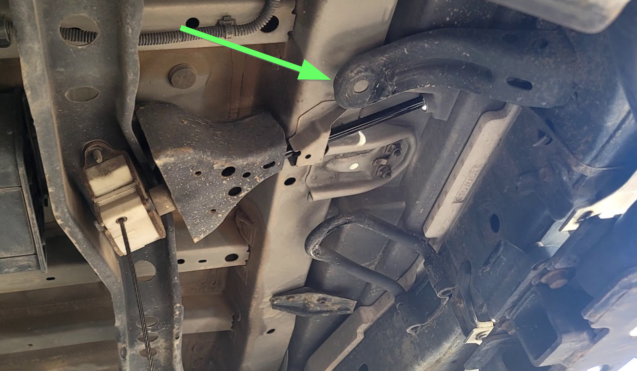

Welp, for anyone curious, here's what I found for my rig after a trip to a shop.
With the stock spare tire lowered and out of the way, I can see the two stopper brackets that might take away some ground clearance when I lift a fat 33" up there:

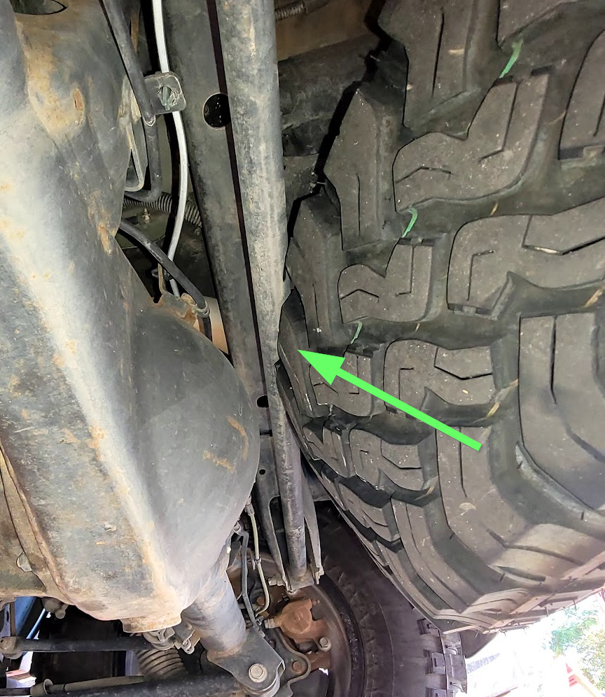

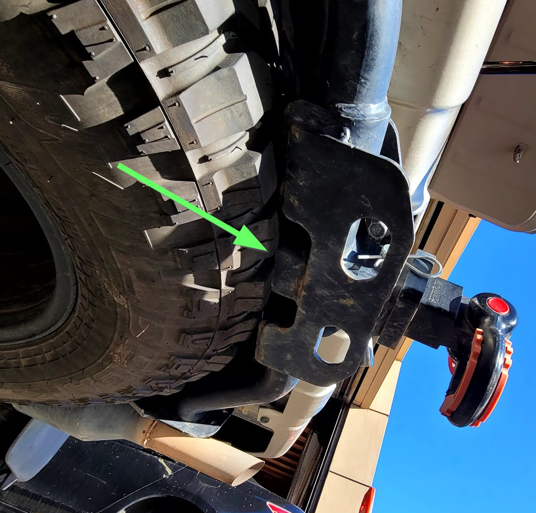

When I lift one of my 33" M/T's into the spare pocket, it won't fit while inflated normally. It will make contact at the tow hitch, and then with a sway bar (?) on the other end:
So it looks like for a 33" tire (fat or skinny), it's going to need to be deflated in order to deform enough to fit into the spare pocket
  • And even then, I probably need to chop the two stopper brackets to gain a bit of clearance with a tire under there.
Does anyone have a different assessment of the situation?
04 v8 here. I have a 285/70/17 Nitto Ridgegrappler on a stock rim that is deflated in the stock spare location. It rubs very slightly against the panhard bar but thats not a serious issue to me. I made no other modifications to make it fit.
Did you need to deflate your 285-70-17 before it can squeeze up there? Or any other mods done around the spare pocket area?
The spare is typically inflated to 20-ish psi. I keep a compressor on board.
No other mods. It helps if you manually "pilot" the positioning of the tire as it's drawn up into the spare space, ensuring that the sidewall doesn't get hung up on the panhard bar as it goes up. The tread of my spare touches against the panhard bar. Been that way for years without any issues.

Let some air out down to 20 ish psi and try pushing up on the forward end of the spare tire as you crank it up into place, so that the tread face slips past the panhard bar, instead of hanging up on it like your picture.
Over the years I've put Goodyear Duratracs, BFG AT KO2's, and BFG MT's, (all 287-70-17) in various states of wear up in the spare location.
Got it, sounds simple enough! I'll give it a go. Thanks!
