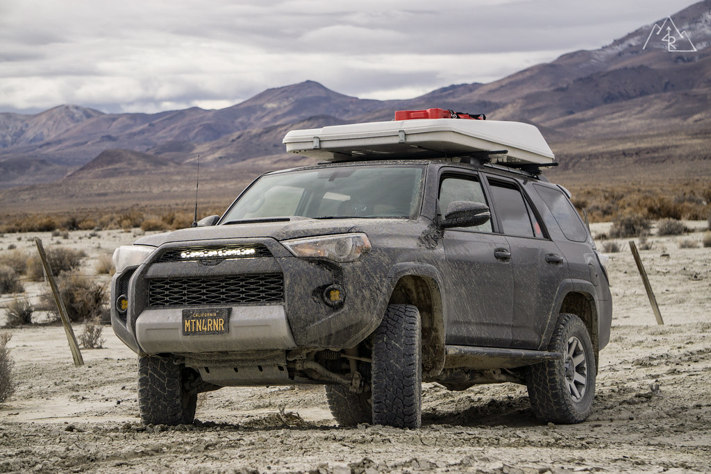

I have had Cooper S/T Maxx 275/70's for 57k and have loved them. I did a full write up that you can check out here. They are E-rated, so they will ride stiffer, but they have been tough as nails and have gotten me through a lot of terrain.

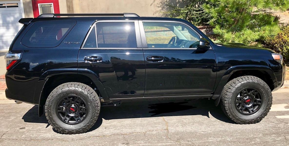

I agree with 91324. I noticed that the KO2’s were just a tad quieter, if unnoticeable, over the P rated Grapplers on my Pro. The E rated tire is slightly more responsive over bumps, but, I soon forgot about it. Ride is good. I like that I can run over rocks and debris with less worry. Also, I don’t have to worry about using chains, in most cases, because of the snowflake icon on the KO2’s, which, the P rated tires don’t have. Although I only have a few thousand on my 275’s, I had 20k on my 285-75-16’s on my previous 4Runner and they hardly looked used. Here is my Pro with 275’s. No clearance issues as the Pro is 1” higher and comes with the fender liner mod.

What fender liner mod do pro's come with? I've seen it mentioned like this but can never find any details or pictures. Thanks

http://www.toyota-4runner.org/tsb/190317-t-sb-0009-15-trd-pro-bumper-fender-interference.html
Besides this, I think the two main reasons the 275’s work on a Pro is, as I mentioned previously, the Pro suspension is 1” higher than other factory 4Runners, and the Pro has a narrower wheel at 7” vs. 7.5”.
Thanks! I was taking my front bumper off yesterday and was wondering why I had to extra holes in the liner and it looked like the fender was cut/sanded. I have an sr5 with the xp predator package but it came with the trd pro suspension. Interesting.
