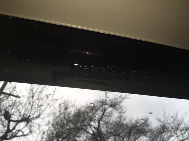

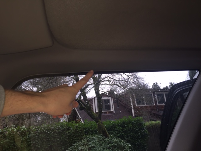

About a month ago, I noticed some moisture on the interior driver side cargo area. The carpet was damp, and there were droplets of water running down the window. I removed the overhead trim where the leak seemed to be coming from, but have had a very hard time pinpointing the source. Here's a few pics I snapped:
This leak seems to run from the driver side rear cargo area up through approximately the passenger overhead handle. Any ideas where this could possibly be coming from?

I don't have a sunroof but on my 01 Accord my drain holes were clogged. The leak stopped after I cleaned them out. I assume the 4runner has the same system.

My guess is from your roof rack rails... That run along the side of the vehicle.
Otherwise if it's generally located near that window, maybe it's a bad window seal..
I would start by removing the roof rack and siliconing in the holes that accommodate the screws to hold it down, then I would take apart that interior plastic and inspect the quarter panel window seal
Or as scramble has said, the sunroof drains commonly will get clogged

My vote is sunroof drain(s) clogged also. Do you park on an incline front up?
I usually park on a relatively flat surface, but I'll definitely start with the sunroof drains and hope for the best. Although Interesting that the water leak would occur towards the back of the Runner if the drains are plugged?
