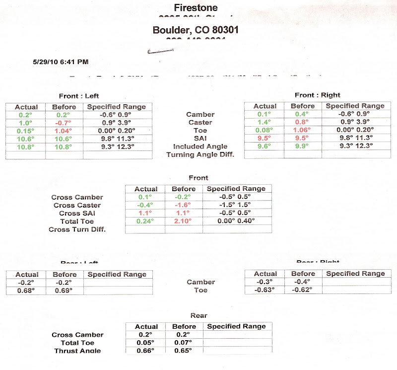

So after all the worrying that I screwed something up after installing my lift I picked up my truck yesterday from the dealership and realized that it all comes down to alignment. The before is on top and the after is on the bottom. The caster is still off on the after because it is set to the lift dimensions and not Toyota's requirements. This took care of the "all over the road" feeling when I hit a bump, as well as the steering wheel not being straight.

Yeah the alignment is important with just about any suspension work. So how does it compare to whatever setup you had before? Find anywhere to wheel it? :D

so like they said above, alignments are important for tire wear so its important so that it prolongs ur tires and puts less stress on ur suspension overall.
Yup definitely important. That's why I posted this to show how far off everything can be after you lift your truck. I know my headline sounds like a question but I just meant its very important. :hatsoff:

What are the caster specs? My OMEs did not come with anything that would specify the alignment requirements. i assume everything else is ordered to stock spec?
