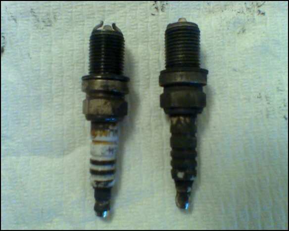

I read the part of the manual that says to only use dual electrode plugs but apparently skipped over the part that says to use Denso or NGK. I had a P0305 cylinder 5 misfire and found that the Bosch Platinum plug had both electrodes burned off. These are rated for 60k miles and only had 38k miles on them.

Interesting, I'll take it as the plug on the right is the bosch one, right?
Looks like the thread to it has been abit lose, at least all that soot shouldn't be there, and the cathode looks burned and melted...
I suppose it's an isolated case, no?

They're actually both Bosch plugs and yeah the soot covered one was loose as hell. The plugs were tightened to the torque specs and the crush washer was flat, but somehow it still came loose. The plug for cylinder 2 was so loose that the boot wouldn't seat properly. I caught that issue about 10k miles ago. The cleaner looking plug pictured had a loose terminal nut. So I think it's safe to say that these plugs failed on every level

Yeah I always used NGK in my dirt bikes and jetskis. NGKs are in the Runner now and I can't remember why I got the bosch plugs in the first place
Now for the Happy news, those burnt off electrodes had to go somewhere......Hoefully they arent doing any damage. I had crappy luck with the Boschs on other Yotas and wont run them but on a Small block Chevy Carb they worked fine for me though. I will be doing the Denso plugs myself soon along with Factory OEM wires.

I'm hoping they passed through the exhaust and are not "honing" my cylinders. I'm glad it's an iron block and not aluminum though. I think that makes the prognosis a little better
Sorry maybe shouldnt have pointed that out. I honestly hope that they slowly disentigrated and didn't harm anything.

That's exactly what should be pointed out! It proves that inferior products have consequences if you choose to use them. Bosch makes some of the best power tools I've used, but they completely fail when it comes to spark plugs. Hopefully my 33% plug failure rate will show others why Denso and NGK are the only plugs that should be used

No objections here! Thanks Thai! I also think it's important to add that I had a ticking sound from the engine that was most noticeable during idle speeds. It sounded like a valve tick or an exhaust leak and had been getting slightly worse over time. LINY4Runner and JohnsD90 both heard the ticking while at the northeast meet. After putting hundreds of miles on it since putting in the NGK plugs, I can safely say that the ticking is gone and was also a result of the Bosch plugs. I would've never thought that plugs would be the cause, but if anyone has this ticking issue I would suggest checking the plugs. If someone other than you has done your tune up then it's possible the wrong plugs are in there.
