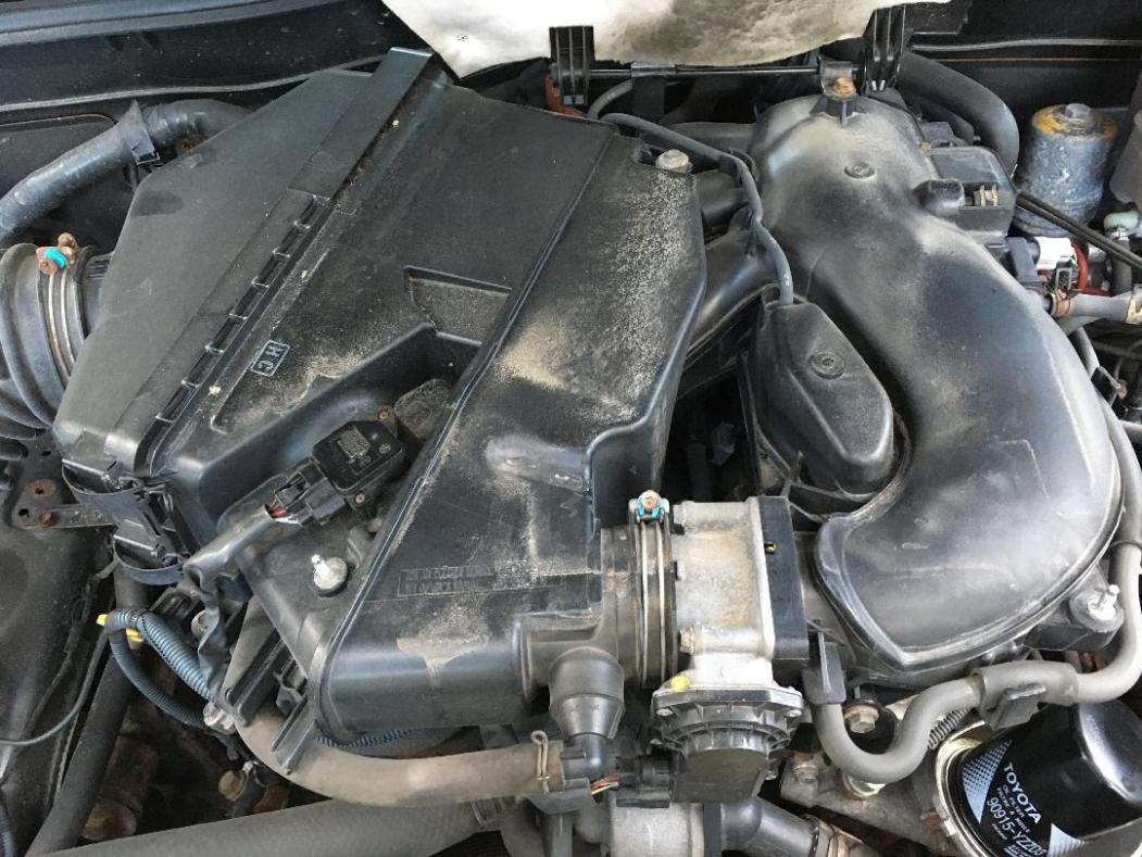

that's the throttle bod in the center of the pic, correct? have to completely disconnect it. the MAF sensor is to the left? any other things out there need cleaning?
Yes, that's it. Do not over tighten the bolts that hold it on. I broke one off once and was very fortunate that the remnant protruded just far enough for me to get a pair of channel locks on it so I could back it out.
