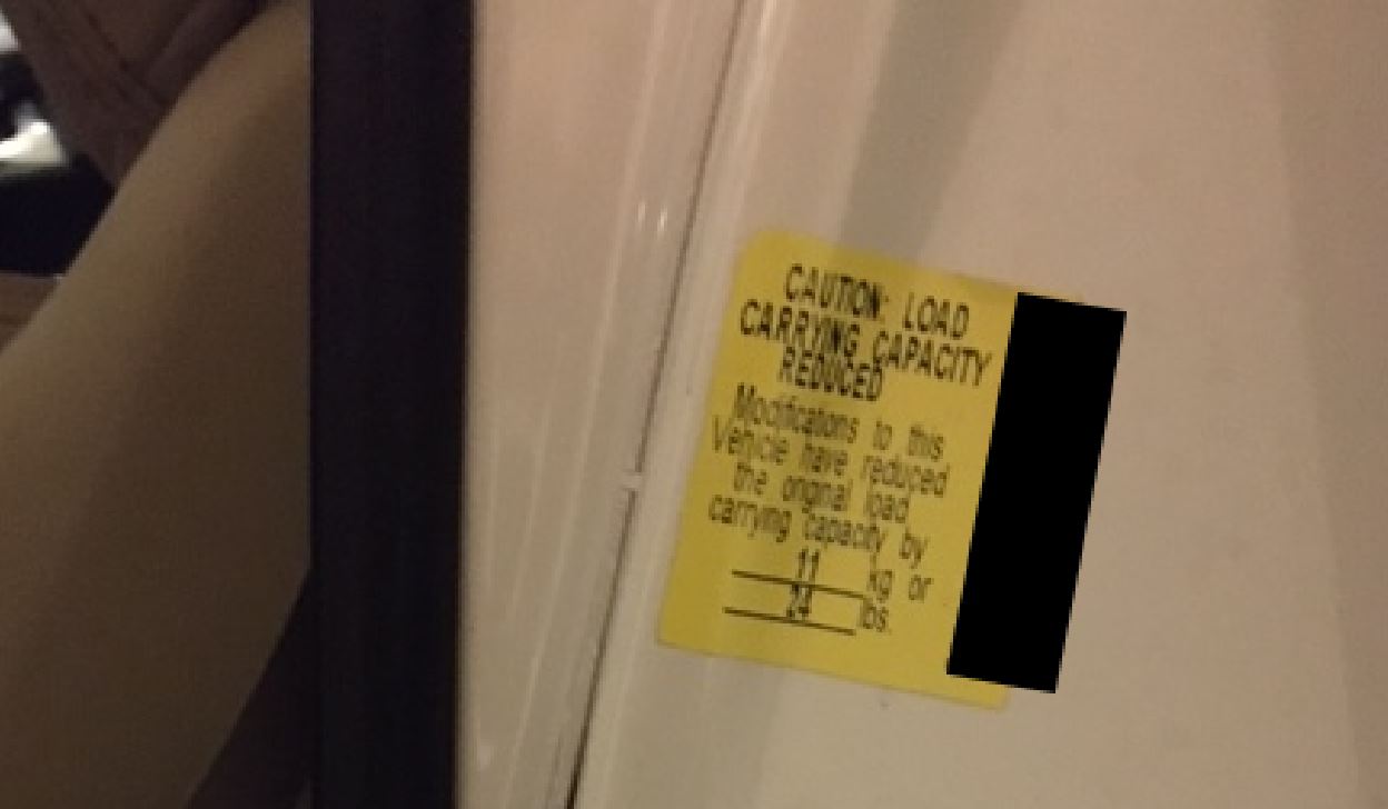

i have bone stock 2017 SR5 Premium but added 2 OEM cross bars on the rails. Possibly that is what caused this amusing little yellow sticker.
