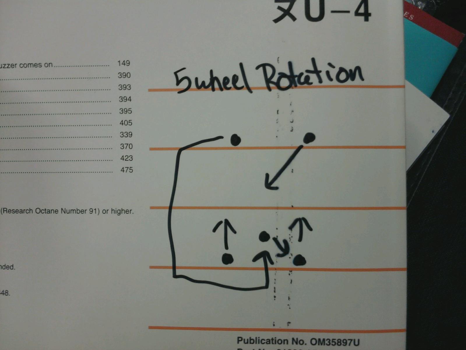

I stand corrected. I checked my manual and it does show your picture. But I follow this rotation pattern (pic below) that I found on the internet.

Ok, so maybe I should start rotating with a criss cross pattern. I notice the dealer so far has not done that. They don't incorporate the spare either, but it is a different model anyway. I notice the previous owner of my truck, who always had it dealer servied, didn't have the spare rotated in since it is bran new. I guess I will have to draw a diagram for the dealer and hope they follow it. It seem Toyota dealers are not big on rotating in the spare according to their manual.
I still don't understand why the spare is only rotated in on the right side with the front/back rotation. What does that have to do with never exceeding 1/4 inch? Wouldn't rotating it on the left side every other time keep things more even?
...I still don't understand why the spare is only rotated in on the right side with the front/back rotation. What does that have to do with never exceeding 1/4 inch? Wouldn't rotating it on the left side every other time keep things more even?

My new plan: rotate tires according to the plan Chayos00 follows.
Good plan.
Well I'm glad to hear that you guys like my rotation plan. I looked for a little while when I first got to the point of needing to rotate my tires, then I came across the method that I use. It seemed to make the most since to me! So I'm glad my rotation pattern is something you guys like!
