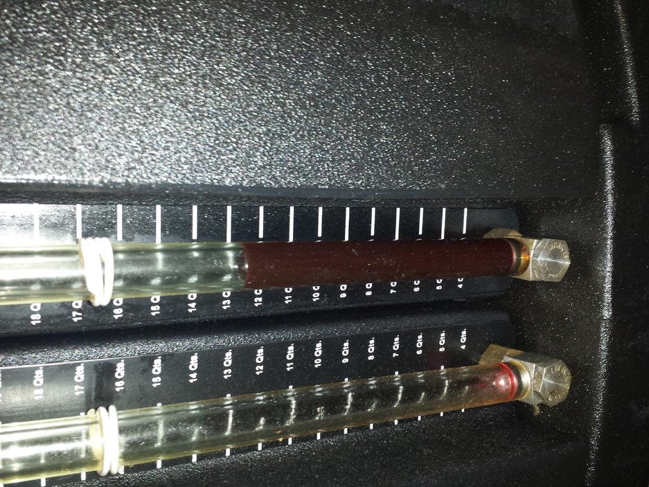

As the title states. Look at the picture

Ugh and the picture loads sideways. I have no idea when the previous owner changed the Trans fluid last. My front diff and transfer case were pretty clean. Front diff was black I guess because the owner was lazy and never took the undershields down
Tell me about it. PO 200000 miles no maintenance.
what am i looking at? is this a machine that drains/fills?
Looks like a trans flush machine. Well worth it in the long run versus dropping the pan since it gets all the bad fluid out of the torque converter and cooler. Not exactly cheap though. I want to say I paid $200 for the last one I had done, which just covered the cost of fluid(synthetic) since a friend has a machine.
I about three days I am doing a DYI trans flush, the cost will amaze you and the efficiency even more. For the cost of the fluids, a magnafine filter, and a small diesel evac pump, I will replacing my fluid with Mobile 1.
Yes it is. It makes life a breeze. took about 10 minutes to setup the lines and for it to swap the fluid.
The truck shifts so much smoother now! It is a night and day difference!
