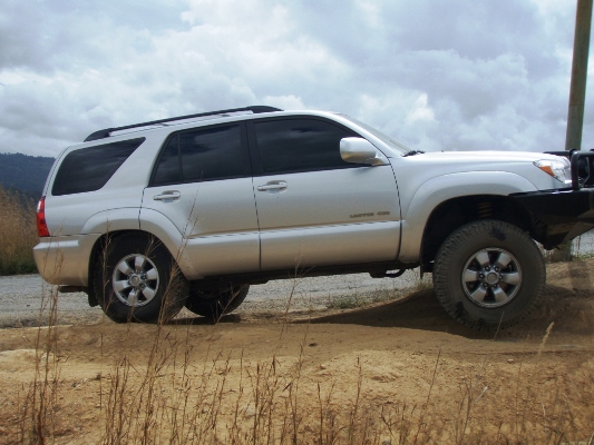

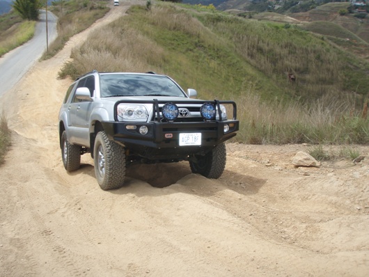

285 At on Stock Wheels
here is mine very little rubbing...........
