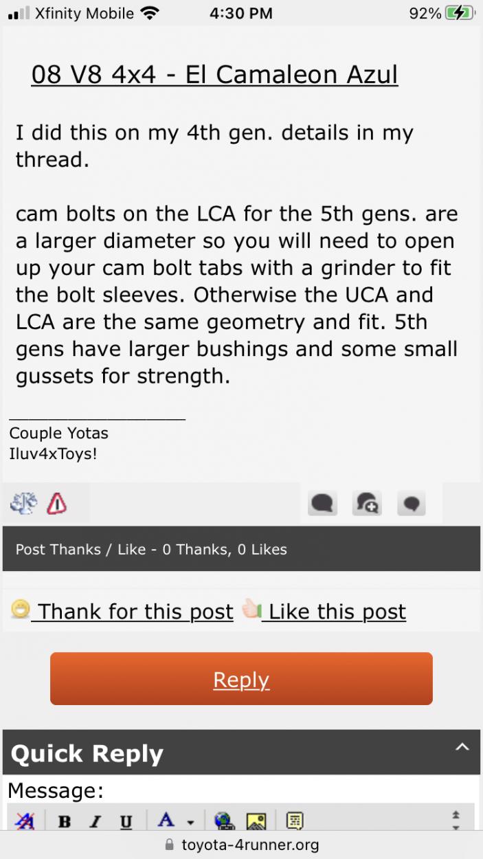

Hi all. Just as the title says will the lower arms off a 5th gen be a direct bolt on a 4th gen? They are considerably cheaper then 4th gens and slightly better built.
Not my info, so try it at your own risk. I found this in an old thread:
