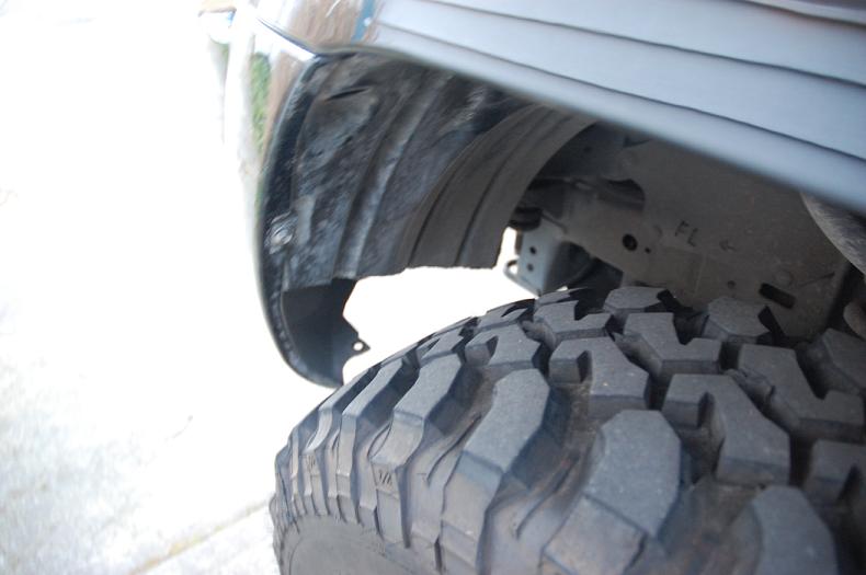

i have the daystar, and after I put new tires on (BFG) there was some slight rubbing at full lock in reverse. Then I put on 1.5" spacers, and it wasn't drivable. Here is the trimming I had to do, but it was easy
As others have said, it will rub worse, but it's simple to fix. Trim or remove the mudflaps and move the fender liner forward. You may need to trim the corners of the bumper cover down a bit but not likely. With 265/70/17s you won't have to cut out the liner like Techmen though. That seems a little excessive, but a different size too.
