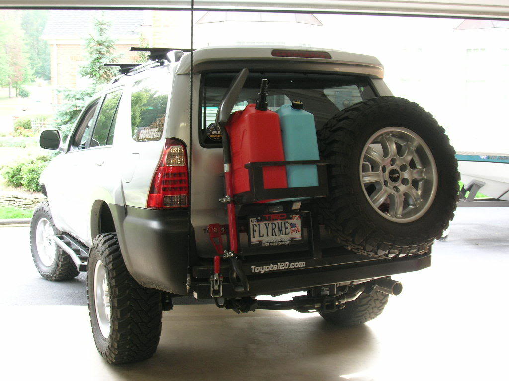

I know Crozhawk had a set of 33x12.5....but he had the 18x9 wheels, spacers and unknown type of lift.
