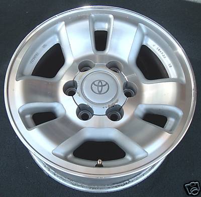

Does anyone know if these rims would fit the 2003's? maybe 2004's and 2005's? :confused:

Find out the lug pattern. If it is 6x139 it will fit all 4th generations, which means 4Runners 03-today
It will not, if your Limited has the bigger brake rotors like the Sport Edition or GX470. 17" or bigger rims are required for the bigger brakes.
I know that when 3rd gen owners change to 4th gen wheels, the wheels are sunken in more. I'm assuming you would have the opposite effect if you did fit those 3rd gen wheels on (they would stick out more than your 4th gen wheels).
