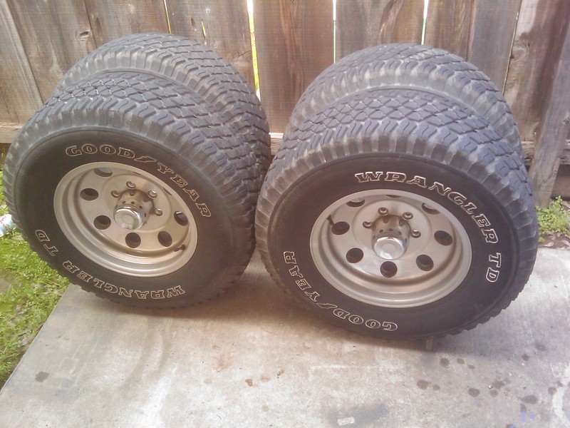

he said there eagle or something like that. $ 400 bux. will it fit a 4runner.
Well it looks like the wheels are 6 lug, so that's a start. 3rd Gen 4runners, and if I'm not mistaken all 4runners have a bolt pattern of 6 on 5.5". If that's what they are then yes they will bolt up, but you should also ask what the wheel offset is. Just by the pictures, I doubt the offset on those wheels is anything crazy, so it shouldn't be a problem, but I would still ask.
Also, those tires are 265/75 R16, so they will fit; the only reason I know they are that size is because that tire (Wrangler TD) only comes in that size. I had some on my truck before.

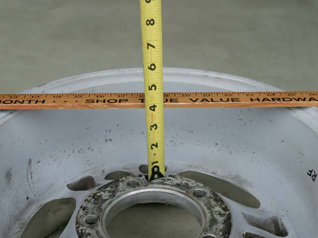

Make sure it's 4 or 4.25 back spacing. In the future if you want to put 33" or 35" tires you won't have any problem tire rubbing on upper arm.
