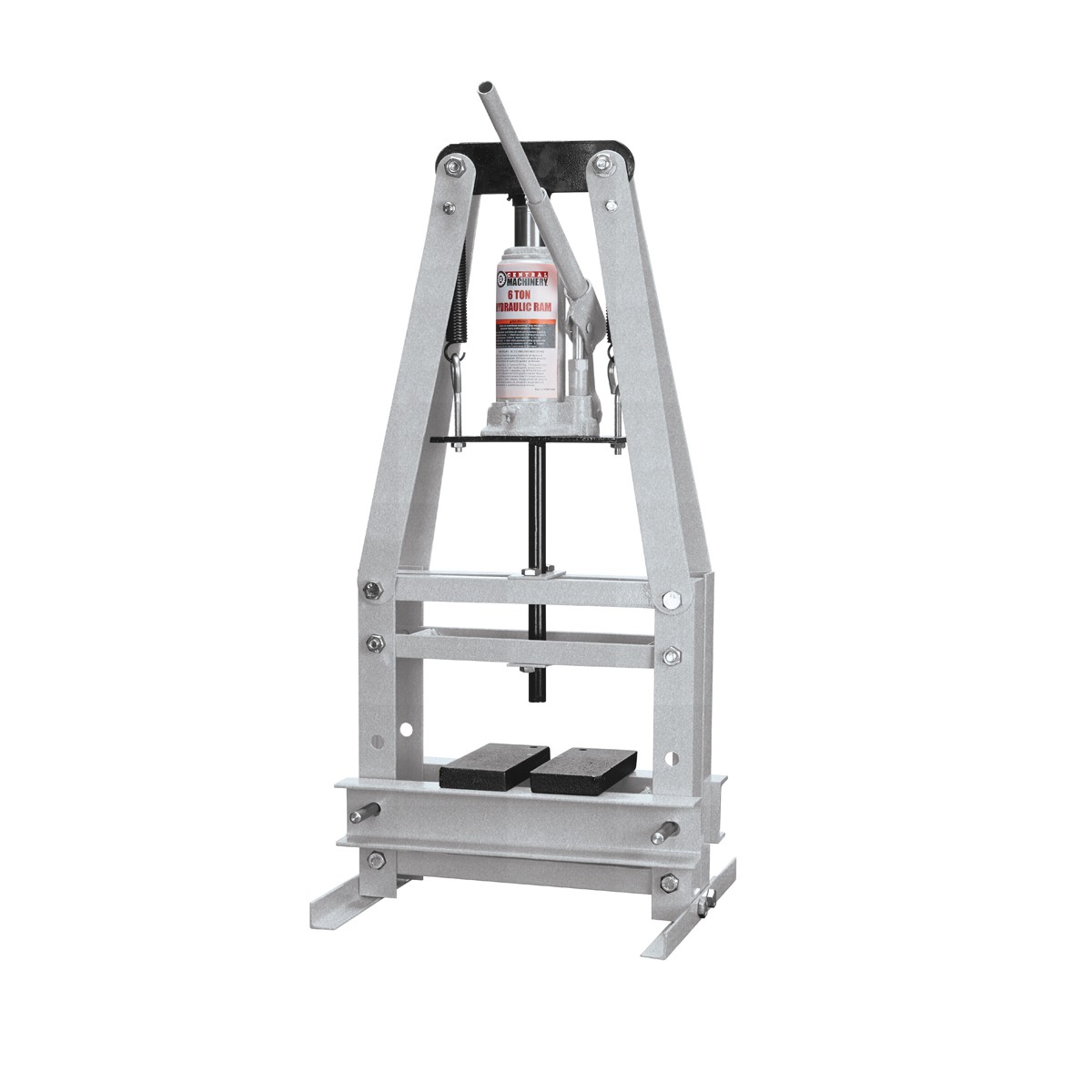

Will this HF press do control arm bushings?
RS Dude
Member
Must replace the junk Moog bushings I installed only about 30k miles ago. Will this press be adequate to do both upper and lower control arm bushings? It is a 6ton. It costs about $60 with a coupon.
Do yourself a favor and buy the 20 ton Harbor Freight press. It's not that much more especially if you wait for one of their 20% off coupons. The 20 ton press can handle all the pressing needs for our rigs. I've gotten a ton of use out of mine.
I have a Harbor Freight 20t press I bought a few months ago to do all my control arm bushings, fr and rr. It’s in brand new condition, $100 and it’s yours to come pick up. I’m not far from you.
Will it. Yes. In fact that’s a over kill for the LCA bushings. I did it without a press. Only bottle jack. However Tim is right. Get the 20ton. And you’ll be able to do almost anything.
