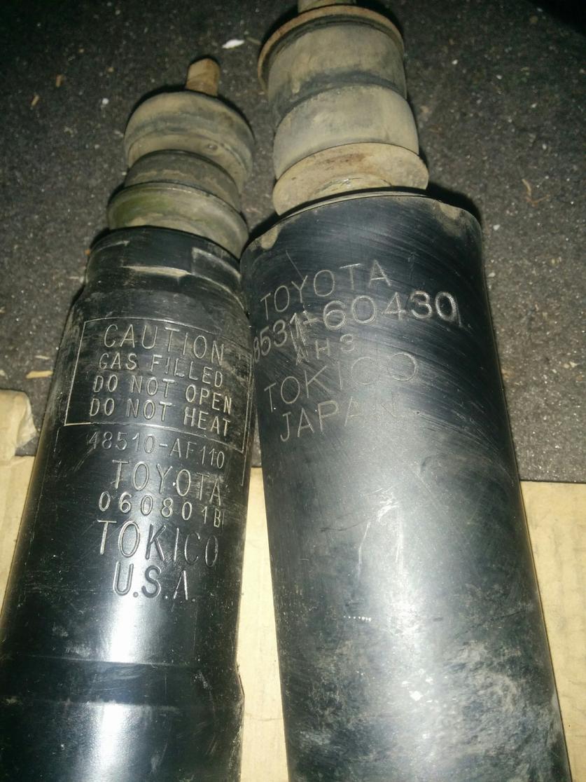

I've found a seller on here that is selling me Front and Back Struts from a Landcruiser. They are LC Black Tokico shocks and I will be getting the front springs to use in the rear. The only thing I would need to grab is for the front LC Shocks is TRD springs or OME springs. Would this setup give my 4Runner a 2-3" lift all around and be compatible fitment wise?
(The Lift FAQ only mentions using LC front shocks onto the rear, no information about using LC shocks to lift the front of the 4Runner.

The lift FAQ does not mention LC shocks lifting the front of the 4Runner because no shock, LC or otherwise is going to lift the front of the 4Runner. Shocks do not lift. Springs lift.

Wouldnt bilstein 5100s work since you can adjust the seating position of the spring? I knkw its not ideal but ive read of people using their stock springs with 5100s but i think they were only able to get 2" out of it.
None of this is even addressing that Landcruisers have a totally different front suspension setup from 4Runners. The front springs and rear shocks will work, but you're still buying used parts and probably without knowing the color coding on the springs. The front shocks will be expensive paper weights to you.
You're talking about a strut, combined with a spring. A shock doesn't have a mounting position for a spring on it, and would not work.
[MENTION=99840]Twan[/MENTION] did a better job of addressing the immediate question, I think. No, OP it won't work.
Oh my bad thats right. Didnt realize he also wanted to use the lc shocks to lift the front.
