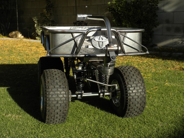

So I know this thread has been dead for a while but life got pretty busy with complications and then having a little baby around the house so I'm over 6months behind my finish date but I got some more work done.
Front axle
Steering knuckle
Rough stance
Ended up ditching the original springs and my brother came up with a great idea and put rc car springs on the inside of the shocks now they look fancy and are actually a useable spring rate (well hopefully)
