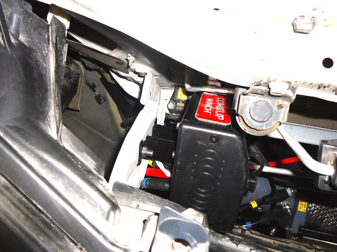

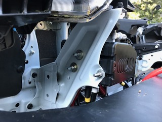

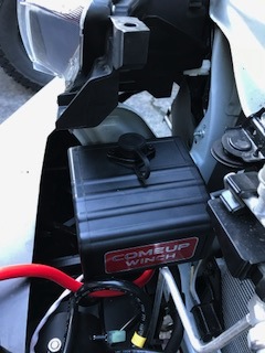

I can't help with the foot forward mounting question, I'd call and ask. But as an fyi if you are going with a ComeUp, the control box has two dovetailed rails in it for mounting which happen to line up with three existing holes on an upright below the passenger headlight. Depending on your bumper it may be difficult to access the controller plug though. I went 9.5k but depends on your usage, 12k seems like lot for a 4Runner. Best of luck.

Yes, my SSO bumper has a flat winch plate behind the bumper. And JSparky has his control box mounted in the same location as mine.

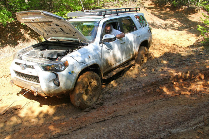

I hooked mine up to a FedEx Mercedes Sprinter van a couple years ago (left side sunk in a muddy ditch) The winch was pulling that fine until the van dug in and the winch started dragging the 4R forward. I had to let some line out to get to better traction and use reverse gear to pull him the rest of the way out. Bad idea but it got the job done.
