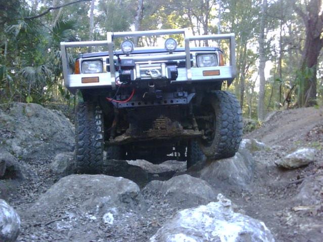

Um... my receiver mounted winch does just fine pulling my 4runner all over the place.
I plan on putting in the wiring so I can move it to the back when needed... someday :)
