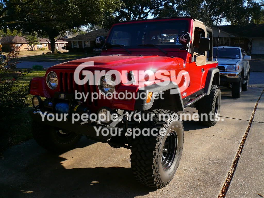

Dont forget to pick up a synthetic line for your winch....also MUCH safer (and lighter) than the steel cable. The colors they come in are ugly as sin, but I wont be caught without one:
P1030157.jpg~original
