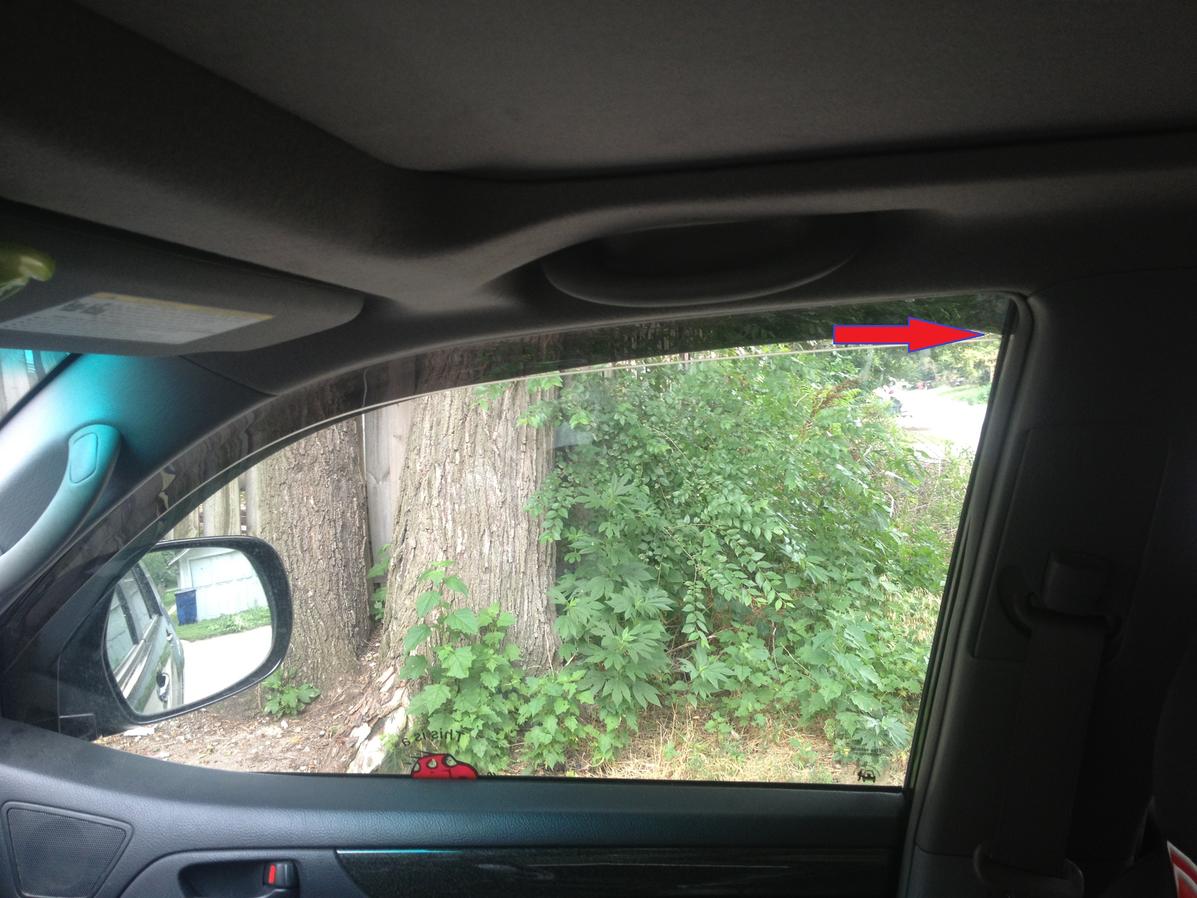

I actually think this is a problem with all "in-channel" window visors. I got some from a guy off of a local facebook consign group for only $10 and even through it blocks the window from rolling up on the front passenger side, the others seem to still work ok.
*Keep in mind if you try to use the auto window roll-up feature, it wont work because the pressure just makes the window roll back down, an easy way to fix this is just to manually roll up the window. Other than that it seems to be ok, at least im ok with the overall situation (for lack of better terms) and don't find it to be a bother since I saved about $50 overall!
Here is my wind visors, I forgot the name of the brand but I think it was just another 3rd party off-brand...
the arrow points to the corner that is pushed in between the channels, not allowing the window to roll-up all the way, easy to just push the visor out a tiny bit and roll up the window with the other hand, could be kind of a problem, but it really doesn't phase me much...
