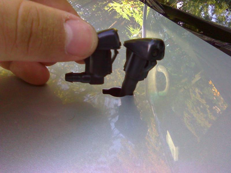

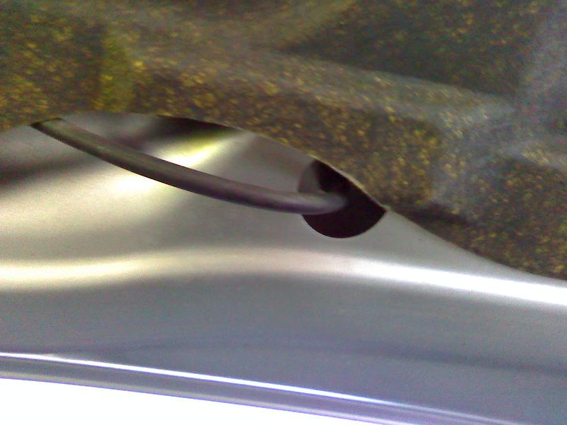

The Taco sprayers do NOT fit our 4Runners. The Taco sprayers have a 90 angle on the hose bib which is incompatable with the 4Runner hood.
Our hoods have two layers, and if you try to use the Taco sprayer with the 90, the hose kinks against the inner part of our hood and it just doesn't work. To make them work you need to cut away part of the inner hood.
I'll post some pics to show the difference. Sorry they are from my phone.

Im sure that you could modify the stock sprayers - simply crimp the end of them so it spreads out more then jets out. Just a suggestion; however, I find they are completely fine.
