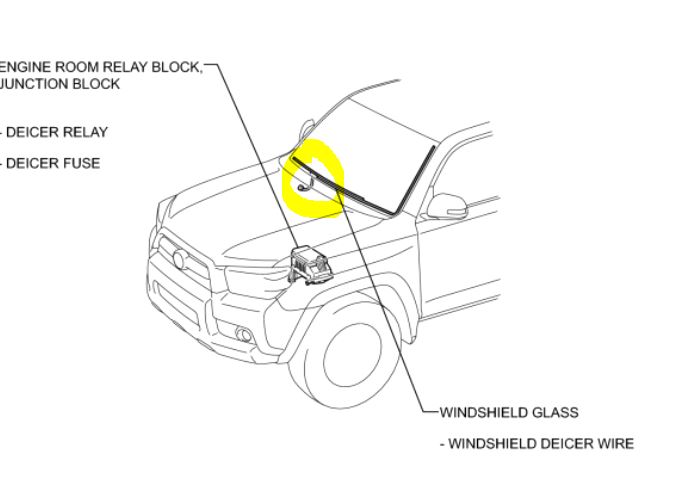

Alight, last year I had the front window swapped out for another factory window, with deicer strips on the bottom. However, I am not sure if the deicer for the wiper blades is working. It doesn't appear to be. So, my question is, in case he didn't plug it in, does it plug into a harness or does it simply sit on contacts? If it is a harness, is the plug inside of the cowl area?
Thanks!
At least from the drawing in the repair manual, it looks like the harness is on the passenger side. See below.

Yeah, I'm wondering if it will even make a difference..LOL
[MENTION=130829]meder24[/MENTION]
Thanks for the diagram!
