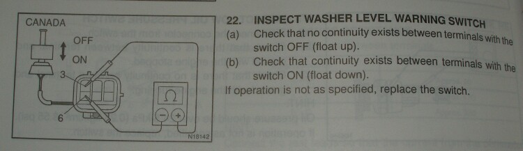

My add fluid light came on in my truck and it was low... and it was... I filled it up like I have many times before but the dang light will not go off... I have disc. the battery two time and let it sit for over an hour, and light still on....
anyone have any ideas....

Let me guess.... you are located in Canada, right?
I just looked through my FSM and it says that the washer fluid level indicator is only available on Canadian models. Here's how to check the switch.

wonder if I can just unplug the switch and make the light on the dash go off.... I really dont care to spend real money on a new switch....
Looking at that diagram, it's a simple switch. I'm thinking the light should go off when you disconnect it if the switch is the reason.
just letting you all know that the switch was bad, I just disconnected it and said who cares about it, light is off on dash and that is all I really care about.
